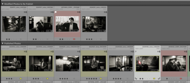

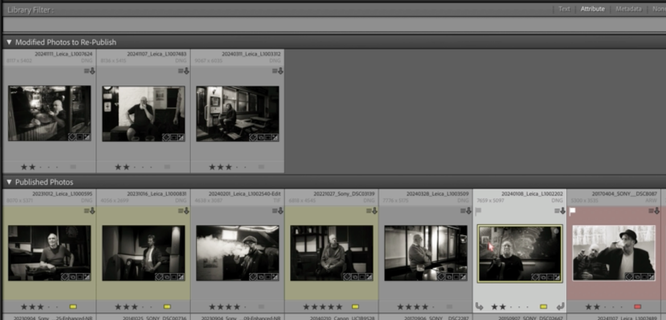

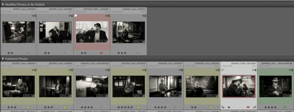

@kimaldis: "It seems to hinge around selecting and viewing images in grid of full frame."
Your screen recording shows the pattern.  When you view an image in Loupe view ("e"), the next photo in the original custom order appears in Modified photos To Re-Publish. (See the screen grabs below.) Here's why this pattern is likely occuring:
One of the conditions that triggers this spurious republishing (there may be several) is upgrading to a new version of LR, where the new version changes the catalog's internal representation of Develop settings. When you do the catalog upgrade, LR doesn't change all Develop settings at once -- rather, it does it incrementally, typically when it needs to re-render an image.
When LR upgrades a particular image's Develop settings to the new representation, it mistakenly thinks the Develop settings have changed in a way that affects the visual appearance of the photo (i.e. as if the user had changed a slider), which triggers the republishing.
In your screen recording, when you view an image in Loupe view, in background LR renders the next image in the custom order, as part of its strategy of making sure the next few images you might view will already be pre-rendered and cached in memory, ready to go when you select the next image . That rendering then triggers the upgrade to the internal representation of the Devleop settings, which triggers the republish.
You can often force the upgrading of Develop settings to occur all at once by selecting all your photos, doing the menu commands Library > Previews > Discard Standard And 1:1 Previews, and then Library > Previews > Build Standard-Sized Previews (and then letting LR run overnight if the catalog is large).  Then you can select all the photos needing republishing, right-click, and do Mark As Up-To-Date.
But that recipe isn't guaranteed to work. In the past, Mark As Up-To-Date hasn't always "stuck". And there is some evidence that there are other conditions (bugs) that triggered spurious republishing.
This thread dates from 2020, but the general problem of spurious republishing long predates that. The problem seems to be not occurring for many of us in LR 14, but there are a few reports like yours that it still occurs. In the past, Adobe didn't appear to make much effort in address it.
