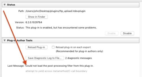

The following expression fails when called from an LrExportServiceProvider script:
LrTasks.pcall (LrFileUtils.exists, ".")
It generates the error "attempt to yield across metamethod/C-call boundary". This makes my Debugging Toolkit difficult, if not impossible, to use with an export service.  (The toolkit uses LrTasks.pcall() to catch errors, and it uses LrFileUtils.exists() to implement a more useful require().)
Tested in LR CC 2015.8 / OS X 10.11.5.
To reproduce the bug:
1. Start with a copy of  "ftp_upload.lrdevplugin" from the "Sample Plugins" folder of the Lightroom SDK 6.0.
2. Insert these lines at the top of "FTPUploadServiceProvider.lua":
local LrFileUtils = import 'LrFileUtils'local
LrTasks = import 'LrTasks'
3. Try to export a photo with FTP Upload. The post-processing action is never invoked.
4. Go to File > Plug-in Manager and observe that the plugin encountered an error:
5. Comment out the lines inserted in step 2 and reload the plugin in the Plug-in Manager.
6. Export a photo with FTP Upload again and observe that the post-processing action is invoked, prompting for a username and password.

LrTasks.pcall() also fails when called from a property table's observer function, producing the message with "attempt to yield across metamethod/C-call boundary" and sending LR into an infinite loop.
To reproduce, make a plugin with a single File menu command running this script:
local LrBinding = import 'LrBinding'
local LrFunctionContext = import 'LrFunctionContext'
local LrTasks = import 'LrTasks'
LrFunctionContext.postAsyncTaskWithContext ("", function (context)
    local prop = LrBinding.makePropertyTable (context)
    prop:addObserver ("x", function ()
        LrTasks.pcall (LrFileUtils.exists, "/")
        end)
    prop.x = 1
    end)
When the command is executed, File > Plug-in Manager shows the following error:
The number of diagnostic messages continues to increase indefinitely.
In practice, it isn't easy to restructure the code to avoid calling LrFileUtils from within LrTasks.pcall(), since there a number of layers of abstraction between the LrTasks.pcall() and the call to LrFileUtils.  Something is obviously wrong with LrTasks.pcall().
