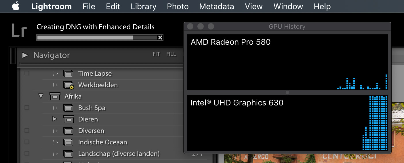

I just tested it and I can confirm that this is indeed what happens. The AMD Radeon Pro 580 is my BlackMagic eGPU, the Intel UHD Graphics 630 is the built-in GPU of the Mac Mini.

This could be a bug in Mac OS.  Enhance Details uses the Core ML API of Mac OS, and there are reports that Core ML doesn't use an AMD Radeon eGPU, as of last July: Can't use eGPU in Image Classification · Issue #883 · apple/turicreate · GitHub . The Apple developer in that thread said he would update the thread when the problem was fixed, and the thread hasn't been updated (which doesn't mean a lot either way).
If indeed it's a Mac OS bug, then LR is waiting on Apple.
