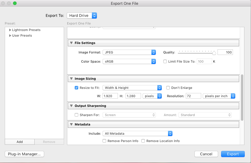

I am using Lightroom 7.3.1 on MacOs Sierra.
From time to time I have the following issue - when resizing RAW images during export into smaller format jpg files the resulting size is not the one that I set up during export.
For example I have a folder with 5472 × 3648 RAW files and I am exporting 1920x1280 jpg files. In the end half of the files are the size I have set to export and half are 1918x1280 (or all of them). I use the option "Resize to fit" and put both dimensions into the export dialogue. I do not change the proportions of the photos or cut them, just do basic lens and colour correction (although isn't this dialogue supposed to resize the photos into the size I need even if I do?).
This happens pretty often and destroys my workflow as after each exportI need to check each picture in case it is not the size the client needs and them manually resize them again. How can I fix it?
Thank you!

This is getting beyond my area of understanding. As far as the images that don't resize correctly are concerned, does Lightroom report the size of the original images being any different than the other images? I really don't have any other ideas.
Jun 19, 2018 Jun 19, 2018
The LR Export "Resize" feature is not an "exact" science. It may not always crop an image to the exact W & H stated in the Resize dialog.
As I understand Resize when stating BOTH Width and Height (eg. 1920 x 1080), you are defining the 'Outer Boundaries' of a "box" that will hold your image for the resize function.  Thinking in this way explains why-
A Square crop image exports at 1080 x 1080  (with w1920 x h1080)  ie. maximum Height in the "box"
A panorama crop might export at  1920 x 720  ie. maximum Width within the "box"
A vertical crop might export at  720 x 1080     ie. maximum Height in the "box"
When your original file (5472 × 3648) is not an exact equivalent ratio, a "two pixel" difference in the exported file dimensions (1918x1280) is totally acceptable IMO from Lightroom!!!!  (why "half or all of them"- a total mystery )
If you want EXACT 1920x1080 pixels you will need to crop and save in Photoshop.

When I view the screen capture of the export dialog I am seeing 1.920 x 1.280 pixels which is not a valid selection it should be 1920 x 1280 there should be no “point” . Just saying.
Regards, Denis: iMac 27” mid-2015, macOS 11.7.10 Big Sur; 2TB SSD, 24 GB Ram, GPU 2 GB; LrC 12.5,; Lr 6.5, PS 24.7,; ACR 15.5,; (also Laptop Win 11, ver 24H2, LrC 14.5.1, PS 26.10; ) Camera Oly OM-D E-M1.
Jun 20, 2018 Jun 20, 2018
Nope. That depends on the language settings of the computer, and is certainly not the problem here. In the English language the point is the decimal sign. In some other languages the comma is the decimal sign and the point is used as thousands separator. My computer language is set to English but my number format and date format settings are Dutch. As a result I see the same thing.

Thank you vey much for the feedback! So basically Lightroom can not resize images with different ration, seems it always works as "make the long side xxx pixels"? Then what is the difference between "Resize to fit" long edge and resize to fit "Width and height"?
I guess my problems do come from one or two pixels that get cropped from the lens correction, I see no other explanation..
Then the only fix is do the cropping to a certain ratio of all the photos before exporting them I guess?
Jun 29, 2018 Jun 29, 2018
Yes, that is the only option. Lightroom will only resize on export, not crop or distort.

You need to have the image cropped exactly the way you want it to look. Otherwise, how would Lightroom be able to choose what to include in image if the program was left to choose dimensions in both directions? Lightroom is very precise in what it exports. In the same tone, you need to be very precise in what you want included in your output.
LEGEND ,
Lens Profile correction by itself does NOT change the image dimensions. The Transform panel, Lens Corrections> Manual> Distortion, and Crop panel 'Angle' controls can change the image dimensions, but it doesn't sound like you are applying them. You can check this for yourself by displaying the 'Cropped Dimensions' in the Develop module Loupe view as shown below. Are the files that produce 1918x1280 export files showing different 'Cropped Dimensions' than those that export as 1920x1280?
I beg to differ. If the lens corrections panel needs to apply a pin cushion distortion of the image (because the lens itself has a barrel distortion), then I believe the image will be slightly cropped to avoid blank spaces in the middle of the edges. And for a non-square image that means a very slight change of the aspect ratio. I think that is exactly what happens to the OP.

Nope, try it for yourself. Here's a Canon CR2 file shot with a 17-40mm lens at 17mmm, which has considerable barrel distortion. The left image has 'Enable Profile Corrections' unchecked and the right image has it checked with 100 Distortion and Vignetting correction applied. The cropped dimensions are identical for both (5616 x 3744).
Only the Transform panel, Lens Corrections> Manual panel> Distortion, and Crop panel Angle controls can change the image dimensions.
H’m, that means the image is uprezzed. Bad choice, Adobe. So how do you explain what the OP is seeing? His original 5472 x 3648 image should resize to exactly 1920 x 1280 if he does not manually transform the image (and he claims he does not).
It's possible he inadvertently applied one of the settings that can change aspect ratio to some files. Let's see how the OP replies concerning the 'Cropped Dimensions' display value for the original image files that export with incorrect 1918x1280 output files. If they are the same dimensions (5472 × 3648) as the files that export correctly as 1920x1280 then I suggest resetting the LR Preferences files as outlined in my reply #12 above.
