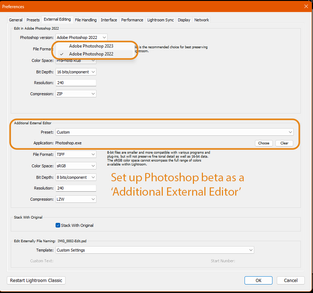

Hi Cory. Recently I saw that the option to choose which PS to use was added in the new lightroom but it seems to only work in Mac. In Windows, you can only see the current one and not the beta. Can you confirm this?lrbeta.png

Hey, @azmil77. I'll help you work around this. Lightroom identifies this through the registry on Windows.
This information is populated based on Windows registries. If you only want to use Photoshop Beta, you can try solution two from this content: https://helpx.adobe.com/lightroom-classic/kb/edit-photoshop-command-missing-photoshop.html
Add the Photoshop.exe from the Photoshop Beta folder instead of the Photoshop 2023 folder.
Let me know how it goes. Thanks!

Hey, @mikel510. I'll clarify this for you. Lightroom identifies this through the registry on Windows.
The drop-down is intended to allow selecting another version of Photoshop on the computer. I have Photoshop 2022 & Photoshop 2023 with Photoshop Beta set as an additional external editor.
Give this a try & let me know how it goes. Thanks!

Copy link to clipboard
Copied
Après avoir beaucoup cherché, j'ai trouvé une solution. Dans Préférences/Edition externe, j'ai mis un lien vers le fichier photoshop.exe au niveau de "application" dans la section "éditeur externe supplémentaire". Ainsi j'ai deux commandes à ma disposition: ctrl + E pour modifier dans bêta et ctrl + alt + E pour modifier dans photoshop 2023. C'est pas l'idéal mais ça marche en attendant que le bug soit rectifié.
Copied
J'ai trouver la solution, j'ai renommée le fichier ".exe" de BETA  Photoshop renommée en photoshop Beta, et sa marche!
