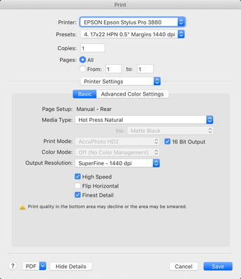

OK, let's try presenting it another way .....
1. This is how I "set it up".
NOTICE a) what's in Printer field, b) what's in the Media Type and, c) what's in the 2 checked boxes below.
Then I press SAVE.
But ........
......... when I come to print - using the same preset, the specs in the fields have changed!!!
What's going on?
See screen shot below.
Any idea how to prevent this?
Is this an Adobe problem or an Epson problem? Or a Raphael problem?

Isn't this - see screen shot, what you refer to as "setting paper and definition" in the Epson driver? If it is, that's how I always set it up. As you can see, resolution is at 300 dpi, and paper profile is set to Epson Hot Press.
Nevertheless, the paper I end up with in the Print window is "Ultra Premium Photo Luster" which is not even checked in my list of preferred Epson papers. So where is the system selecting it from?

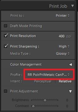

Oct 20, 2019 Oct 20, 2019
I believe I have been giving you some wrong information 😞
I think I see now that your [Save] button does the same as my [OK] button, so, yes, you need 'save' the printer setup. (Mac vs Windows ?)
Have you installed or re-installed a Printer lately? If you have done this I believe this may reset your templates printer setup, and for your 'User' templates you would have to 'update' these.
(I recently replaced two printers and my templates all defaulted to A4 - presumably my default mono-laser)
Can we be sure?
My recent tests (Windows-10 Lr 8.4.1) show me that the Printer setup is stored correctly in my templates (after updating for the new printers!), so I am sure of mine, but I do not know why your setups have changed- sorry!-
Screen-clips:
My A4 template and the Printer Setup
My 4x6" template and the Printer Setup (without adjusting!)
I would think it is an Adobe problem- Also raise you problem at- Photoshop Lightroom Family
