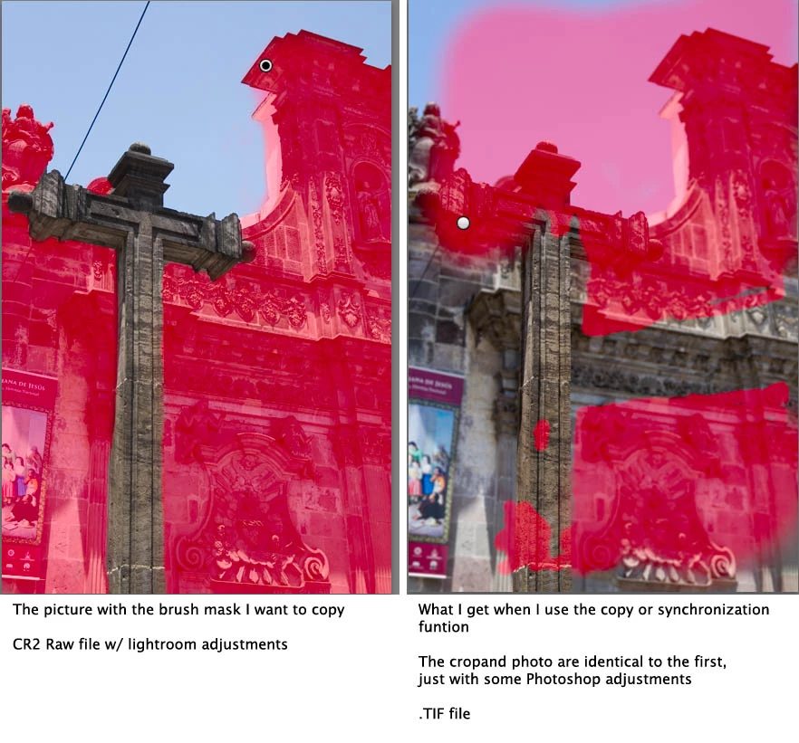

Hi all!
I have two copies of the identical photo.  The only difference is that one copy has had some photoshop changes and is a .TIF file, and the other is a raw file with a few lightroom adjustments.  No changes to the crop, rotation, angle, etc. have been done that might skew a localized adjustment mask.  I am using Lightroom 5.0 on a PC.
I have an adjustment brush mask on my raw file that I would like to copy over to the .tif file.  I've tried both the copy settings/paste way of doing it, as well as the synchronize way of doing it (both times ensuring that all 'Local Adjustments' options and 'Process Version' were selected and nothing else).  Both approaches have the same result, and in both cases the result is way off.  (I've attached a photo to show what I mean).  What am I doing wrong?  It's not even close enough to warrant slight adjustments on my part.  I even exited Lightroom and re-booted it.
As you can see, not only is the mask way off, but the pin for the adjustment isn't even in the same place.  Any advice?
Thanks!
    최고의 답변: Sean McCormack
    I'm guessing this is a portrait orientation? I'm also guessing that Lightroom is reading the in camera orientation and applying it with metadata. When you save back from Photoshop, it has a new vertical orientation, not an internal one from metadata, so Lightroom is copying the mask sideways.
    This happens with the Grad filter or used to happen and was a pain for making presets.

    April 16, 2019
    That would make sense as the cause of the problem.  I tried bringing the .tif back into photoshop, rotating it onto its side, bringing it BACK into lightroom, rotating it back to vertical, and THEN applying the mask.  And it was definitely closer to what I'd expect, though not perfect.  Because apparently, the edits I did in lightroom before the original export to photoshop (which had the edits embedded into the new image) were not taken into consideration when copying the mask?  It seems really weird that the adjustment mask is being copied as if on an original photo and doesn't take into any consideration the orientation or adjustments already made to said photo.
    Do you know if there's a work around or an option to copy settings as-is-now and not as-before?
    Thanks so much for your help!
    superducki작성자
    April 16, 2019
    As far as Lightroom is concerned the Tiff is a new photo with no link to the original photo.
    I understand that.  But I'm more baffled by LR being unable to copy an adjustment mask on a vertical oriented photo without flipping the adjustment mask 90 degrees counter clockwise.  I guess my question wasn't clear, but I was just asking if there was a work around to get LR to copy/paste the mask exactly as it's shown.  To not being able to accurately copy location-specific settings just because it's not a landscape-oriented image seems like a design flaw.
    Right now the only workaround I've found is importing photos in photoshop, rotating them, re-saving them, and re-importing them on their sides, pasting the mask, and then re-rotating them back to their original portrait-mode orientation.  Just wondering if there is a more efficient way.
    Thanks!
