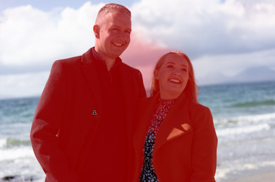

Hi
I have recently moved to a Mac Studio M1 Max. Mac OS Monterrey 12.4 (latest version) I have also reinstalled the OS in case it was an issue on that side.
The select subject does not work... the process runs but it doesn't select a subject (see screenshot)
I have installed Lightroom and the select subject works well in that programme so I assume it is not the computer?! I don't want to move to Lightroom though so that's not a long term option.

New Here ,
May 26, 2022 May 26, 2022
Hi
So they are all RAW photos. Sky selection seems to work well athough I don't often use it. I have tried lots of photos with prominent and various subjects. All get similar results to the sample image shown.
The cameras in question are Sony A7IV, Sony A7III and Sony A7SIII.
Rosetta Emulation is already on.
Thanks 
LEGEND ,
Select subject doesn't always work as you would expect. Sometimes it "goes crazy" as you see. There is no option right now to refine the results, so you could (yes, I know this is not a very desirable solution) subtract areas by brushing them. Other alternatives are to do the masking in Photoshop, which will probably do a much better job and also has the ability to modify the mask.
You're screenshot of 'System Info' indicates that you're running Lightroom Classic (LrC) 11.3.x using Rosetta Emulation. This is neither necesssary or desirble.  Also note that there is a bug with 'Select Subject' when using emulation mode, which results in very poor subject masks. Best results are obtained when you  run LrC in native Apple silicon mode.
To launch LrC in native Apple silcon mode right mouse click on the application icon, then choose Get Info. Make sure 'Open in Rosetta' is unchecked as shown in the attached screenshot.

New Here ,
Jun 16, 2022 Jun 16, 2022
You're right! I had "open using Rosetta" in the info panel checked. That resulted in LRC selecting everything of other things and never the subject.
I unchecked the box and voila...LRC seems to mask as designed.
