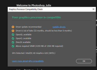

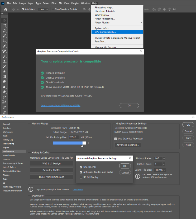

New Here ,
Nov 24, 2021 Nov 24, 2021
I am having the same issue works on android and apple apps just not on my desktop.  I have upgraded intel graphics
What desktop OS and Application versions. If  Photoshop does Photoshop menu Help>GPU Compatibility show your GPU is supported and Drivers are up to date and all features are working OK?
JJMack

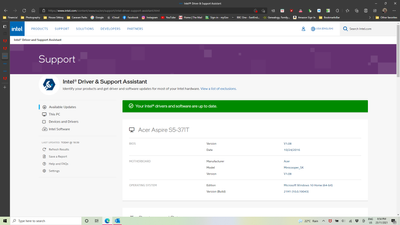

New Here ,
It is saying that it is up to date.
Enthusiast ,
Nov 25, 2021 Nov 25, 2021
From what I can see, the most up to date driver for your Intel(R) HD Graphics 620 is version 30.0.101.1069. You can download it from Intel's driver download site.

New Here ,
Thank you, nope still no joy.
I'll take my laptop for someone to have a look at it
LEGEND ,
"Thank you, nope still no joy."
Does that mean you successfully installed Intel's latest driver (30.0.101.1069) and Select Subject/Sky still doesn't work?
