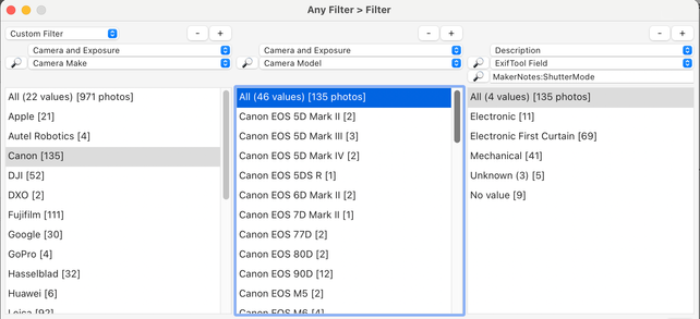

The EXIF industry standard doesn't provide a standard field in which to record the type of shutter, so manufacturers will record such non-standard information in the proprietary Makernotes metadata section. LR doesn't display Makernotes, but the Metadata Viewer plugin referenced by Ian does.
Looking at my catalog of raw samples, the Canon EOS R6 II records this Makernotes field:
[MakerNotes] Shutter Mode : Mechanical
I have sample raws from 46 different Canons, and here's what's recorded for Shutter Mode:
