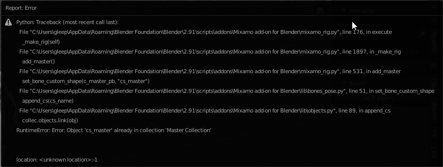

Hi! I run a Blender YouTube channel (southernshotty) and was excited to do a tutorial on the new mixamo add on, but it's not currently working for me.
I'm getting a recall error when generating the rig and it breaks the rig. Removing part of the arms.

I also got an erro ron a certain file, though when i start the file from scratch and import the FBX from Mixamo again it does work.
For ne the issue was when its start to generate, it returns an error "cs>master already in Master Colection". I got that fixed my self by adding an extra line in objects.py #89. This is the line i added and added 1 indent to the 2 lines below
if not collec in obj.users_collection:
What is your exact error output, could you paste the error from the console here or add is as text file?

I get that error in 2.91 and 2.93.2
Advisor ,
Aug 15, 2021 Aug 15, 2021
I got 2 fixes for that one, one is start from scratch by importing the FBX again in to blank blend file or use this script.
For ne the issue was when its start to generate, it returns an error "cs>master already in Master Collection". I got that fixed my self by adding an extra line in objects.py #89. This is the line i added and added 1 indent to the 2 lines below

Hello, i also am getting errors trying to run the Create Control Rig button.
Python: Traceback (most recent call last):
  File "C:\Users\George\AppData\Roaming\Blender Foundation\Blender\2.93\scripts\addons\Mixamo add-on for Blender\mixamo_rig.py", line 176, in execute
    _make_rig(self)
  File "C:\Users\George\AppData\Roaming\Blender Foundation\Blender\2.93\scripts\addons\Mixamo add-on for Blender\mixamo_rig.py", line 1900, in _make_rig
    add_arm("Left")
  File "C:\Users\George\AppData\Roaming\Blender Foundation\Blender\2.93\scripts\addons\Mixamo add-on for Blender\mixamo_rig.py", line 1804, in add_arm
    add_driver_to_prop(rig, 'pose.bones["'+arm_name+'"].constraints["'+cns_fk_name+'"].influence', 'pose.bones["'+c_hand_ik_name+'"]["ik_fk_switch"]', array_idx=-1, exp="var")
  File "C:\Users\George\AppData\Roaming\Blender Foundation\Blender\2.93\scripts\addons\Mixamo add-on for Blender\lib\drivers.py", line 28, in add_driver_to_prop
    drivers_list = obj.animation_data.drivers
AttributeError: 'NoneType' object has no attribute 'drivers'
location: <unknown location>:-1
I'm using the latest version of Windows Blender 2.93.2
I uploaded a mesh to mixamo to get the skeleton/skin fbx file.
imported into a blank scene in blender and then tried to run the tool.
I also tried adding the code you mentioned to objects.py but still didn't work:
# assign to new collection
            assigned_collections = []
            for collec in cs_grp.users_collection:
                    collec.objects.link(obj)
                    assigned_collections.append(collec)
Any idea how to fix it?
