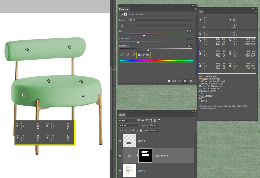

hi i need to change white fabric of chair to green fabric as attached picture

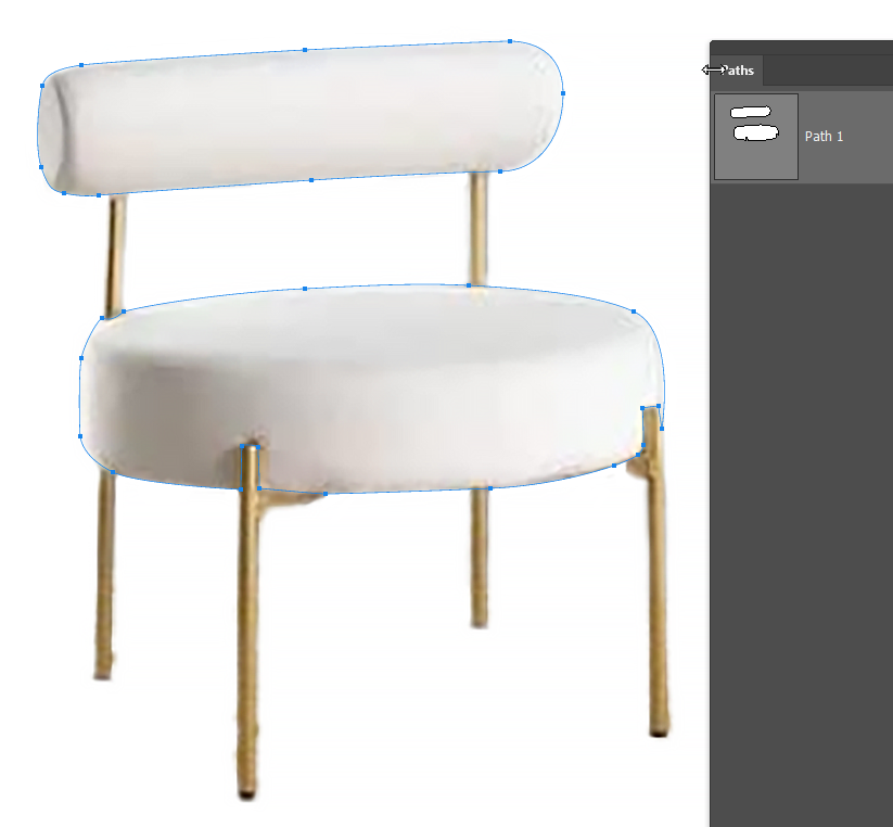

We have a problem in that the image of the chair is too small to work with reliably.  I have doubled the size, but that has resulted in a lack of sharpness.  If your original is larger in pixels, and sharp, you might be able select the fabric area with one of the Ai tool, but I had to use the Pen tool to make a clipping path.
I have Ctrl clicked the path to load it as a selection, and added a Hue/Saturation Adjustment Layer.  This automatically masks out everything outside our selected area.
I made a number of color sample points on the fabric with it set to 5x5 pixel average.
I copied the resulting values in the Info panel, and pasted to the chair document so I could try and make the chair the same.
I have placed a number of color sample points on the chair fabric, and moved the Info panel so I could see the results of my color edits
I now click on Colorize in the Hue/Sat properties panel.
I can see that the red and blue channels were very close in value on the fabric, so I adjusted the Hue slider to get that on the chair fabric.
The rest I diid subjectively, which was to lower the Lighteness and Saturation.
That gets the colour close. Did you also need to apply the green fabric texture to the chair fabric?  We'll need a much better screen shot of the chair to help with that.
