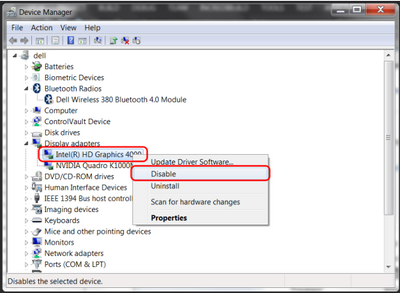

Please try to deactivate the CPU inrternal GPU in device manager in Windows and check.
More informations you'll find here: https://helpx.adobe.com/photoshop/kb/troubleshoot-gpu-graphics-card.html
If this doesn't help, please post your Photoshop system info. In Photoshop goto Help > System Info and hit the copy button. Then paste the entire informations into this thread.

It came through - it just takes time to process that much data. Please stop multiple posting.

Have you had any luck with fixing that issue? I'm in the same boat, but with Photoshop 25.0.
Explorer ,
Oct 13, 2023 Oct 13, 2023
it was solved for a while but after the new updates it is still the same.

Thanks for the tip, but that seems like just a temporary fix.
For me, enabling the Older GPU mode just makes photoshop slower and sluggish, but at least it doesn't crash...
