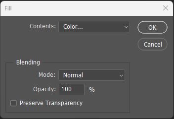

I believe I have spelled out my procedure clearly enough previously, so see no need to repeat myself.  However, I am uploading a screenshot.  I did a cutout of an object (a car) and created a blank layer beneath it (see Layer 1). With "layer 1" tagged, I simply Shift+F5 and select "Color".  That function no longer works as my selected color is indicated but does not fill the intended layer.

Trevor, I believe I've previously mentioned that I have pre-selected my "color of choice" (which is green) from the Fill contents menu (which includes three (3) options: Foregound Color, Background Color, and Color).  You guys do use Photoshop/Photoshop Beta right?
Anyway, I have already solved this issue.  Somehow within the Fill contents menu, the box for "Preserve Transparency" got checked.  Unchecking it solved the problem.
