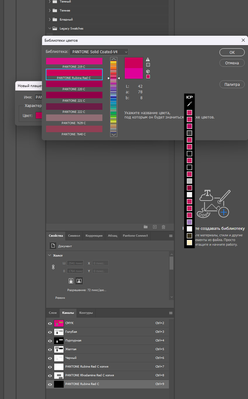

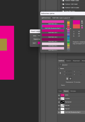

That screencast does not happen anymore in Photoshop 2023.
Engaged ,
Nov 01, 2022 Nov 01, 2022
Photoshop 2023
Engaged ,
@ZBalling thanks for confirming that — that's good to know
did you confirm that it works correctly the other way, too? that if you type in "Rubine" you do in fact get Rubine, and it doesn't switch to Rhodamine? (I'm wondering if it's just switching reading the database from top to bottom, or bottom to top and now the other one is first.)
Engaged ,
It is also fixed in latest 23.5.2 update (BTW, does it mean that never before Rhodamine Red was used, no wonder Pantone withdrew from Adobe).
Engaged ,
Yes, Rubine Red also works. Can you confirm that on your side with printers and stuff?

Engaged ,
Jan 26, 2023 Jan 26, 2023
Does not happen on windows 11 22H2, Pantone Purple C does not become Medium Purple either.
I am using 24.1.0.
