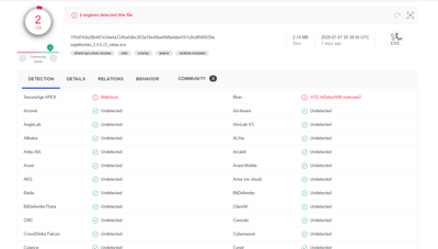

Just so people know the latest sage thumbs has virus warnings ("sagethumbs_2.0.0.23_setup.exe")
https://www.virustotal.com/gui/file/705d743e28b487e34a4a7245a0dbc303a10e45ba0fd9e4da4101c8cdf506839a...
For whatever reason it used to be on Google code.. but then became private.
https://code.google.com/archive/redirect/a/code.google.com/p/sagethumbs?movedTo=http:%2F%2Fwww.cheru...
-> sagethumbs_2.0.0.19_setup.exe for me doesn't raise red flags.

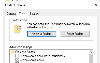

Jan 28, 2021 Jan 28, 2021
Simply uncheck this box from the windows explorer view options , which is how photoshop displays things as well.
LEGEND ,
Photoshop uses the system preferences of Windows Explorer.  Open explorer and go to the view options.  Make sure the "never thumbnails" is unchecked.  then :
Apply to all folders (button up top)
Participant ,
wow. reviving a 9 year old thread! I see things move slow.  i've since gone to mac, is it possible there as well 🙂
Explorer ,
This solution is something you'd THINK would work but nope... still doesn't solve the fact that no photoshop thumbnails still to this day. When Adobe removes a feature they really don't do take-backs.
