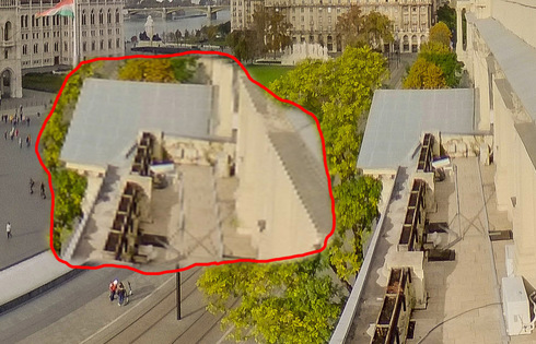

i work with 360 panorama images taken with dedicated cameras
and sometimes i need to edit the pictures (remove tripod, fix other parts)
all worked fine with this workflow:
3D - spherical panorama from layer - making the needed changes on a new layer - merge down the new layer - export panorama.
but recently i noticed that when opening the panorama image in 3D view, the details become pixelated horribly.
and so if i make a change (healing brush), that part of the image will not be the same quality as the rest.
strange thing is that if i just export the image without changing anything, the quality is still perfect!
see the attached image, all i did was copying my head next to the original, using the workflow above, and exported the pano.
as you can see, the left is sharp (even though in 3D view it LOOKED pixelated!) and the copied one on the right IS pixelated.
so it seems to me that the 3D view is the problem.
noticed after installing PS 2020.
but even when i try it in 2019 (which worked fine before) now it's the same issue there as well.

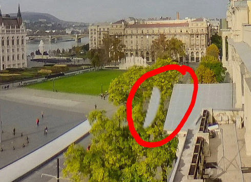

so, this is PS version 21.0.1
i just made a better example to show the problem:
method:
open equirectangular panorama image - 3D - Spherical Panorama - New Panorama Layer From Selected Layer(s) --- (at this point i can only see the shitty pixelated image) --- create new layer - Healing brush tool (replace mode) - (copying the roof line, the cupola, etc) - merge down - Export Panorama.
Now. As for the resolution question:
imported image size: 6720x3360 px
exported image size: 6720x3360 px
so no issue there!
As for the quality though:
the copied parts are blurry, pixelated (as copied from the shitty 3D view), the rest of the image is just like the imported image, sharp.

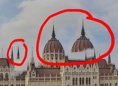

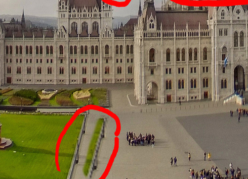

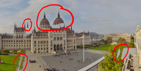

to see the details better:
this is just awful.
