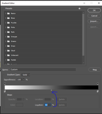

Hi!
See where the arrow is pointing to in the following screenshot, please click on that little box. Then you should see a  small diamond underneath the gradient. Can you take a picture of the Gradient Dialog when you see that and post it?
Michelle

Dec 28, 2021 Dec 28, 2021
I apologize for sounding so harsh! There is no need for you to apologize, I just wasn't explaing correctly where I wanted you to click--it is my fault.
But, thank you! That is exactly what I wanted to see. If you draw with this gradient now, do you get the effect you want? Or are you still having issues?

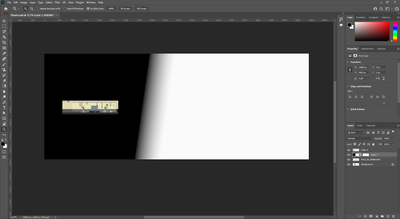

Sorry it is still having the problem. The black layer appears on the screen again whe i drag the gradient red room to the black area as I want it to slowly become trasnparent to black. Like this person face i did

Hi! There are a couple of ways you can do that:
1. When you are creating your gradient, you can change the opacity in the Options bar:
or 2, You can create the gradient on a layer and then change the opacity of the layer. I think this option gives you more control over the gradient after you've drawn it.
Michelle
Also, to get a longer transition from red to black, you can change your toolbar setting "method" to Perceptual.
