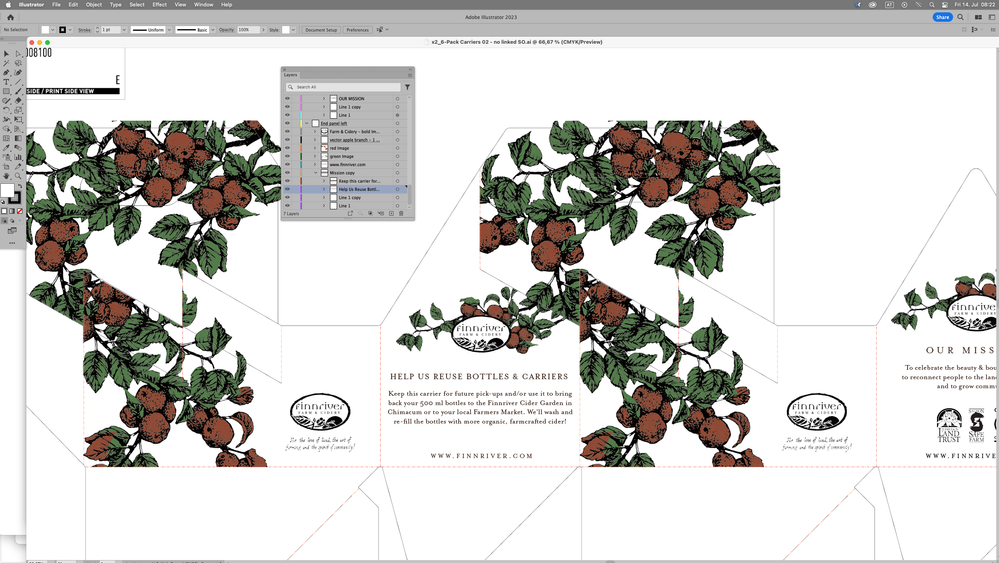

An issue I had not foreseen is that the Color Overlay Layer Style on the Type Layers will not work out in Illustrator.
But by removing those I could at least get the Type Layers as editable text in Illustrator. (see screenshots)

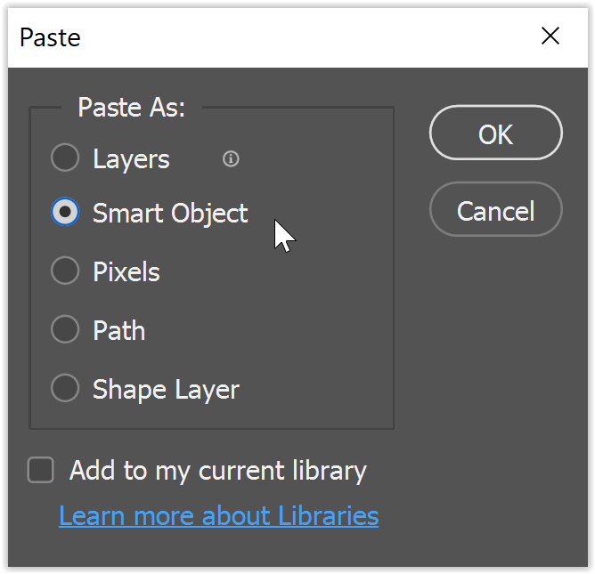

When you copy a vector file and paste it into Photoshop you get a choice of how you want the vector to be placed.
