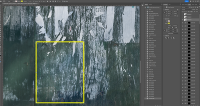

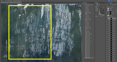

I think the following can be achieved using Channels but I don't know how, as I have very little experience with them.  In the first screenshot, I have a Curves adjustment layer lightening the highlights in the area bounded by the yellow rectangle.   Even though the Curves layer is applied to highlights only, it is somewhat affecting the entire area.  I only want the white paper pieces lightened, and not the dark green background.  (In the 2d screenshot, the adjustment layer is turned off, showing the unaffected background as I want it to appear.)   Is this best done by using Channels, and if so, how?  Thanks.

Right click on the Path layer thumbnail, and select Blending Options from the pop up, to open the Layer Style dialog:
In particular, note the Blend If section. It can operate on all channels (Gray), or Red, Green, and Blue individually. The sliders on the controls below can be split, by Alt-dragging one side, and the blend will occur over a range.

Amazing!  That works great.  By dragging the control from the left towards the right, the shadows are made darker.  Per the message while hovering over the control, I used the Alt key while dragging to produce a similar - perhaps somewhat better? - result.  I don't understand what is being "blended" - shadows and highlights? - or what that means.   "Blending" to me suggests that the distinctions between shawdows and highlights are being lessened, but that's not what I would descirbe as happening here.  I guess I can read up on it online.  Anyway, thank you for providing a solution.
