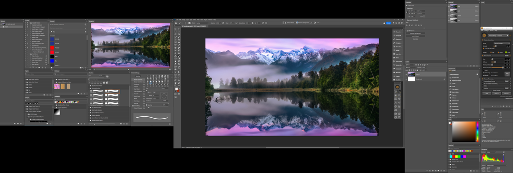

There's a lot to be said for using multiple screens with Photoshop.  Having the major panels always open is a joy, and it definitely speeds up your workflow.  Things like Ctrl clicking a path to load it as a selection, for instance.
This is my default workspace.  I had both peripheral screens in portrait mode for many years, but I had to change the left screen to landscape for a Prem Pro project earlier this year, and decided I liked it better with with Photoshop.  One thing I'd advise if setting up for multiple screens with Photoshop, is to try and find 16:10 monitors.  Mine are both 24" 1920 X 1200, (as opposed to the much more common 16:9 1920 X 1080).  The extra pixels make all the difference with setting up a Photoshop workspace.   This 5680 X 1920 (it lost a couple of pixels when I grabbed it)
What I am forever saying on this forum, is to do with saving shortcuts and toolbars with Custom Workspaces, and to switch between them with Actions triggered by unmodified Function keys.  It never gets old hitting F5 and seeing a messed up workspace tidied up two seconds later.
