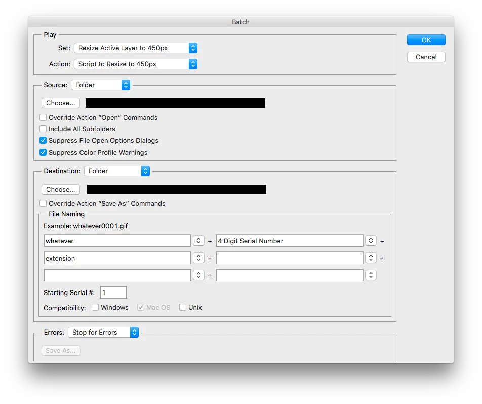

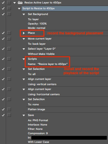

Sure, one way to do this is with an action and the batch automate command:
Action contents:
File > Automate > Batch setup:
Results:
background = common background image
oldpics = old pics
newpics = output of batch action combining oldpics + background
Notes:
1) The action needs to place the common background image file, however as the background is being placed into the oldpic document, the old pic document was assumed to be the same canvas size as the background. This assumption may not be correct.
2) The action makes use of a script to resize the selected layer content to a target pixel width, assuming that the source content may vary in width. This may not be required if you have a consistent source/target value and a standard transform/resize would work.
3) The resize script works from the centre and the placed layer is centred, however I added the align steps to centre to demonstrate anyway, even if redundant.
This was all very much rough and ready and done in 15 minutes, it could likely be done better with more forethought and planning.

Stephen MarshCommunity ExpertCorrect answer
January 27, 2017
Action contents:
Results:
oldpics = old pics
Notes:

Change line 12’s value of 450 to the desired pixel width.
Without sample files it is hard to comment with specifics, however everything worked in my tests using the assumptions based on my dummy test files.
Let me know if you need any help!
