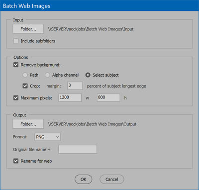

I just posted on another related thread:
https://community.adobe.com/t5/photoshop-ecosystem-discussions/jpeg-with-outline-path-to-transparent...
That thread inspired me to make something that should do the job. It's fresh out of the oven, started only hours ago, so it could have glitches still. Just let me know any problems. Also I'll attached an image. If this solves the problem, I'd appreciate marking it as the answer. Thanks.
http://www.marspremedia.com/software/photoshop/batch-web-images
