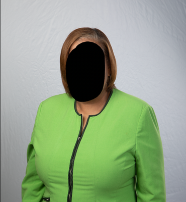

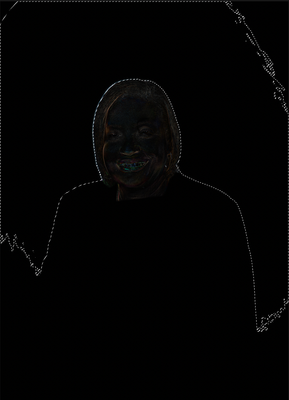

New Here ,
Feb 14, 2023 Feb 14, 2023
Hey Michael,
Thanks for posting this. I can't access the link, so I've tried to walk through the steps and I'm getting stuck on the isolation in step 3. By isloate, you mean select right? When I try to select, it's selecting elements from the original image. I'm not sure how to get it to select just the difference.
