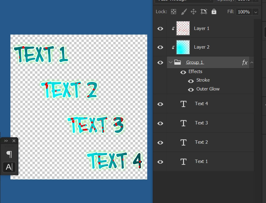

Hello everyone! Sorry for my limited English that I could not explain it more clearly at the title. I really need a help, then I will tell it as details as possible:

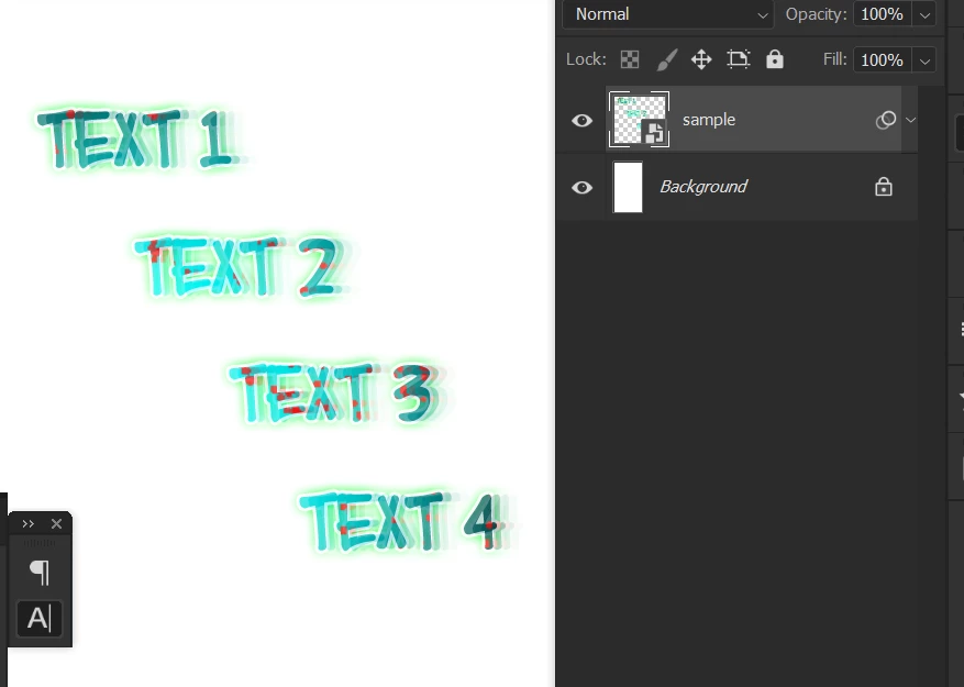

For example, I have a smart object like this

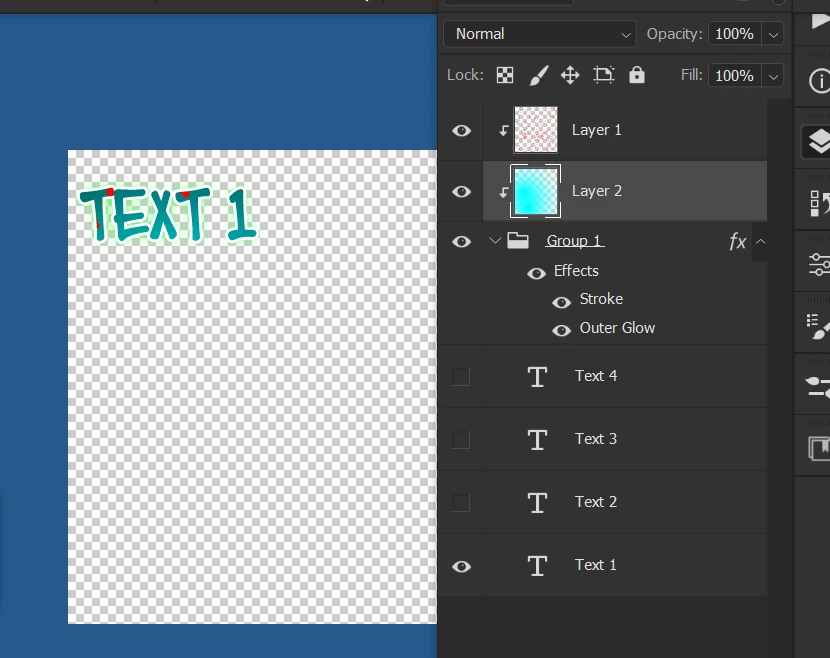

Inside the Smart object, there are some text layers. The text layer and clipping masks are not fixed, sometimes ther are 2, sometimes are 5. But the text layers always in a group

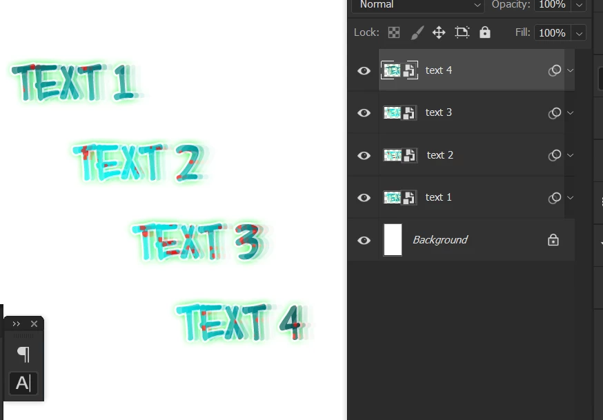

My work requirements is separating these text into separate smart objects but keep the smart filter and original color inside, like this:
and so does I do that by New smart Object via Copy and edit content of every new object by keep hiding the others & showing the target text:
but now I met a super great smart object that contain 50+ text layers inside, and I've wasted half of a day just to separate it 🙂 I did known a script could split layer to layers, but I cannot rasterize the object because some need to modify then.
Anyone have an idea? I am extremely grateful that you could help!

OK, this is proving to be a little harder than I first thought!  :]
This isn't the first time that I have bitten off more than I could chew...
So far the script will create a new smart object via copy for all of the required layers.
I have not yet worked out the bit around cycling over each smart object and turning off the visibility for the "unwanted" layers.
Perhaps another scripter could step in?
Anyway, I'll post what I have so far as it may speed up some of the work for you.
