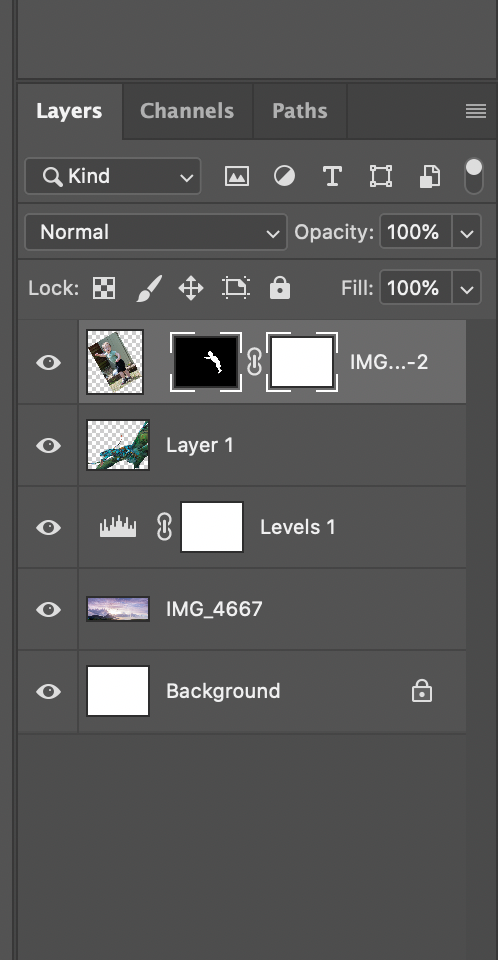

can you show screenshots of what you have going in your layers?
New Here ,
Jul 28, 2020 Jul 28, 2020
Thanks - I've poped in a screenshot.  Really basic I know but I just want to reveal and hide bits of each layer.

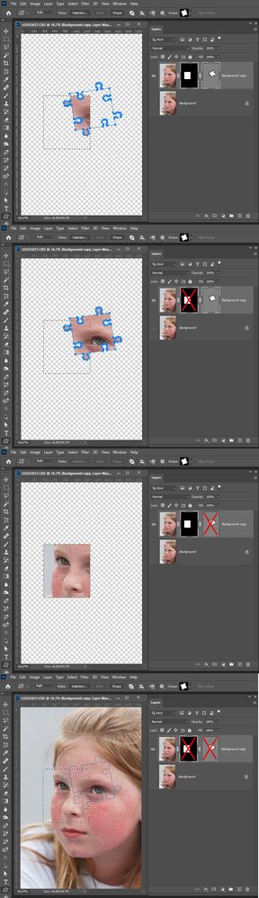

If you add both  a raster layer mask and a vector layers mask to a layer only the areas that are visible in both mask will be visible in the layer . The intersection of the two selections.... It like masking a shape... If you want a layer mask to apply to more then a single layer you need to duplicate the layer mask for each layer or group the layers and mask the group.  Masks hide pixels.  You hide upper layer pixels to show lower layer pixels in the hidden areas of upper layers

Hi mglush,  I've also attached screenshot of my layers (probably looks a mess but I am a beginner,lol).  Just trying your solution....

...not sure what I've done with the dragon layer.  When I double click on it I get the blending options panel so I think I've rasterized it?  There is no save option in Paths for this but has worked with the boy.
Yes, it looks like you rasterized the layer. You can tell because of transparent background. It looks like JJ has taken care of your other questions! Have fun wiht your project and let us know if you have any other issues.
