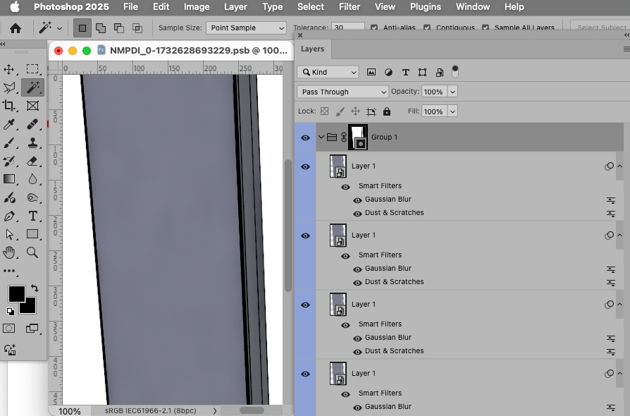

Screenshot 2024-12-04 at 12.10.44.pngScreenshot 2024-12-04 at 12.10.49.pngScreenshot 2024-12-04 at 12.11.39.png

Try using Photoshop's Blend Modes and Gradient Map adjustment layer. Apply a gradient map with shades of gray to the texture layer, and experiment with blending modes like Overlay or Soft Light. This should help achieve a smooth, blended gray effect efficiently.

I am sorry, i could not understand what was happening and i felt stupid if i kept asking the same question. so i just used the blur tool...
