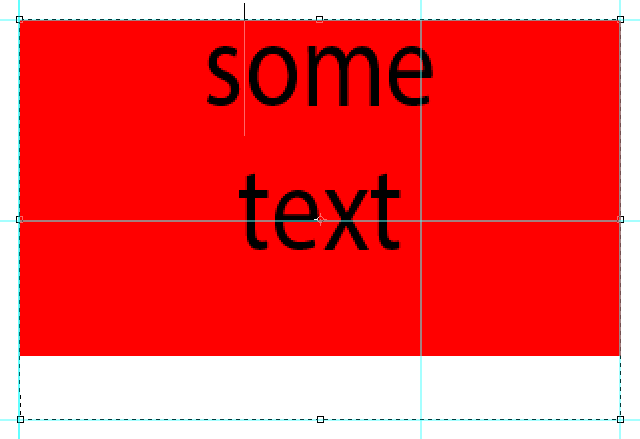

No, the text isn't transformed, but I'm not trying to get the height of the text itself. I'm trying to get the height of the text box itself. I've attached a screenshot.
I've included a screenshot that shows the box that was drawn under the text object based on the position, height and width values. As you can see, the box isn't extending as far as it should. Here's that code:

The height should be approximately 200 pixels but is reporting at 168ish. The width is obviously fine.

I tried your code and it works just fine here… I used CS5 to try it… Here is a screen shot… I just put a solid fill layer at the bottom so you can see the guides…
Script editor's event log gives me…
