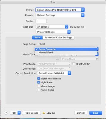

The Epson printers can be a pain with 'paper feed source' at times. It doesn’t matter to that, though, what specific media you're using, the issue is that when you choose the media type** the feed source is automatically set. I don't have that printer so can't give you any specific screenshots.
The ICC profile selected in "Photoshop manages color" has no bearing on the driver's paper feed - so you'd be having the same issue with an Epson paper with the name you've set in 'Media options' .
Heres where media feed is set on my 4900 [in print settings], different options of course as it’s mainly a roll printer :
[**I hope the paper manufacturer has specified the media type you should select in the Epson driver since gettting that right is vital if the ICC profile is to work)
