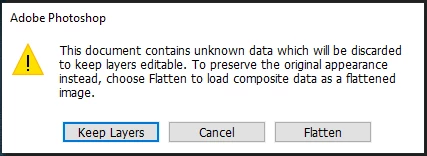

A couple things I need to adjust that I'm aware of are when the script opens the file and this prompt pops up
I still need to figure out how to always apply the "Keep Layers" option (if anyone know I would be forever thankful)

I'm confused: 'I'm running the newest release 23.2 and I still get "Keep Layers"'.
That was my mistake, I thought I was on 23.2 on my local but I was running the same version that the virtual machine had.
I ran an update to 23.2 and that fixed the prompt issue
