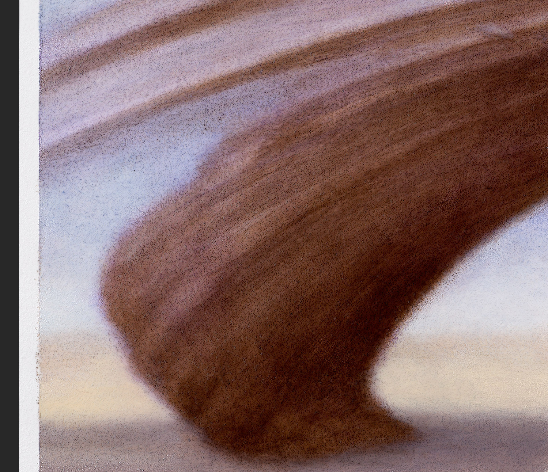

I'm helping an artist put together a catalog of his life's work. A lot of the images are scans. Because the originals were on canvas, there are a lot of undesirable artifacts. Not just the usual scratches and dirt you expect from a scan, but little white specs like this, which I assume are caused by stray light rays bouncing off the rough surface.
Seems like it would take forever to go in with a tiny spot healing brush and zap each one; it would also harm the character of the brushwork, at least using the "normal" setting.
Could anyone suggest an efficient way to clean it up?

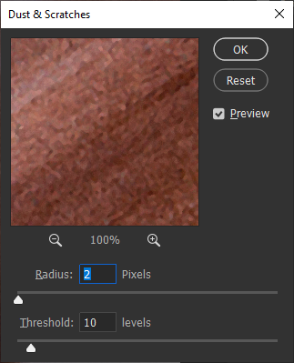

Hi
You could try the Dust and Scratches filter

Hi
