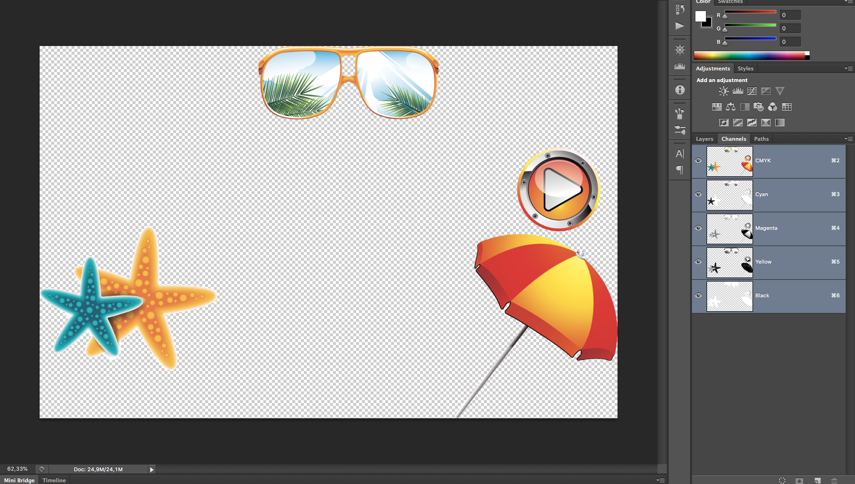

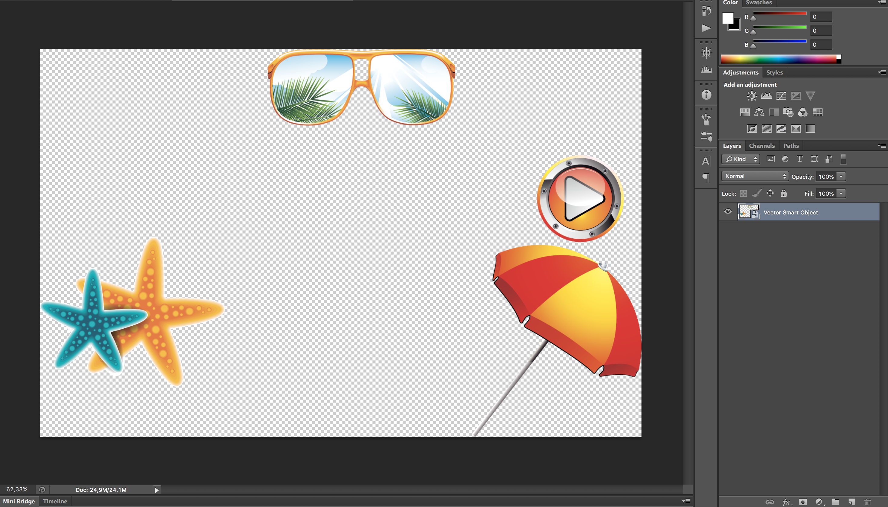

I want to know how to transform a CMYK image into a predefined number of spot colors in a professional way. For printing in aluminium can.

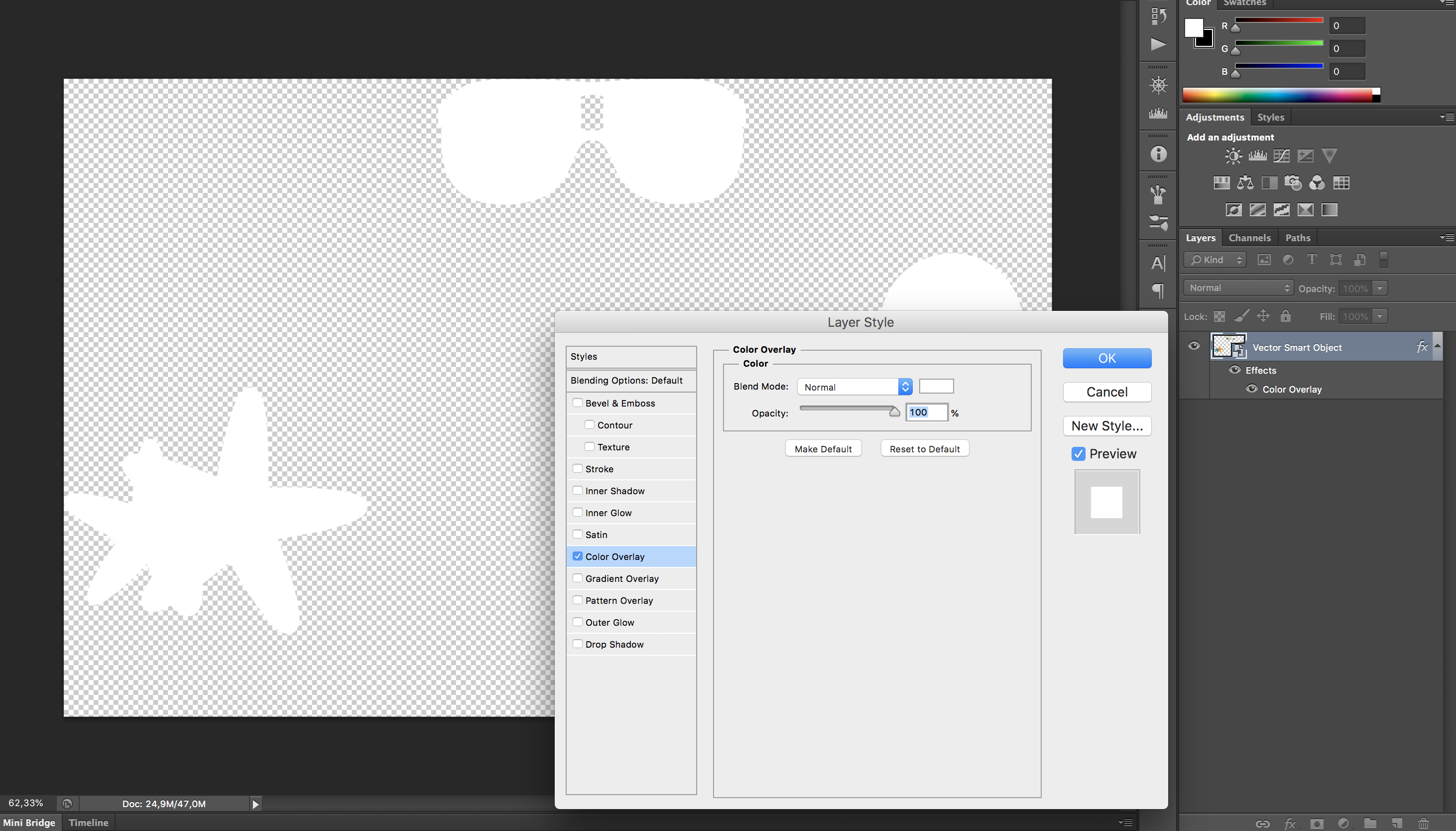

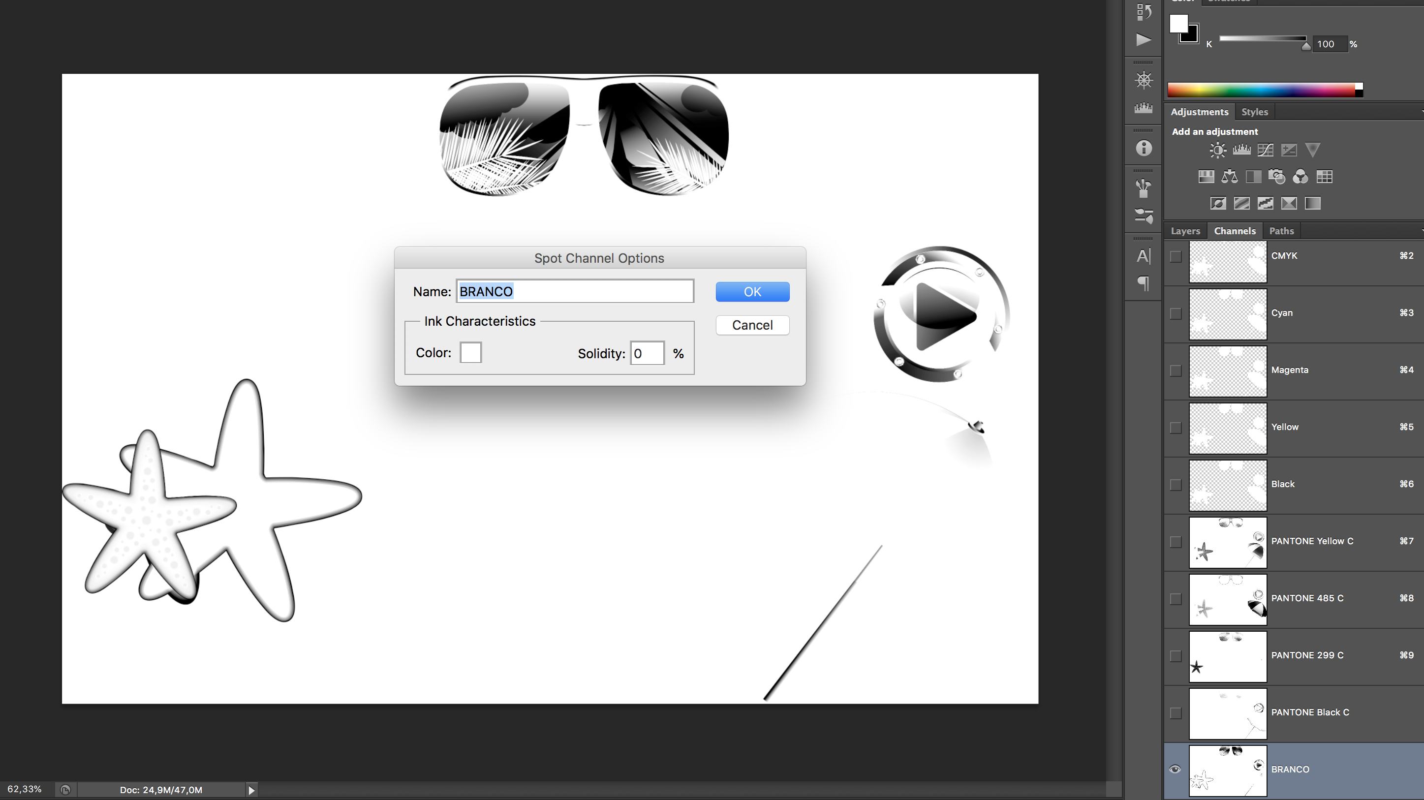

I have some screenshots from a file (ready for output) and its layers/channels. Does anyone knows this workflow? I don’t know how to do it and I’m trying to discover. The only thing I know is: the person has used 'apply image' to separate and create the spot colors and a pure white 'color overlay' on the cmyk channels.
1- these are the layers (with a white color overlay and it’s cmyk channels:

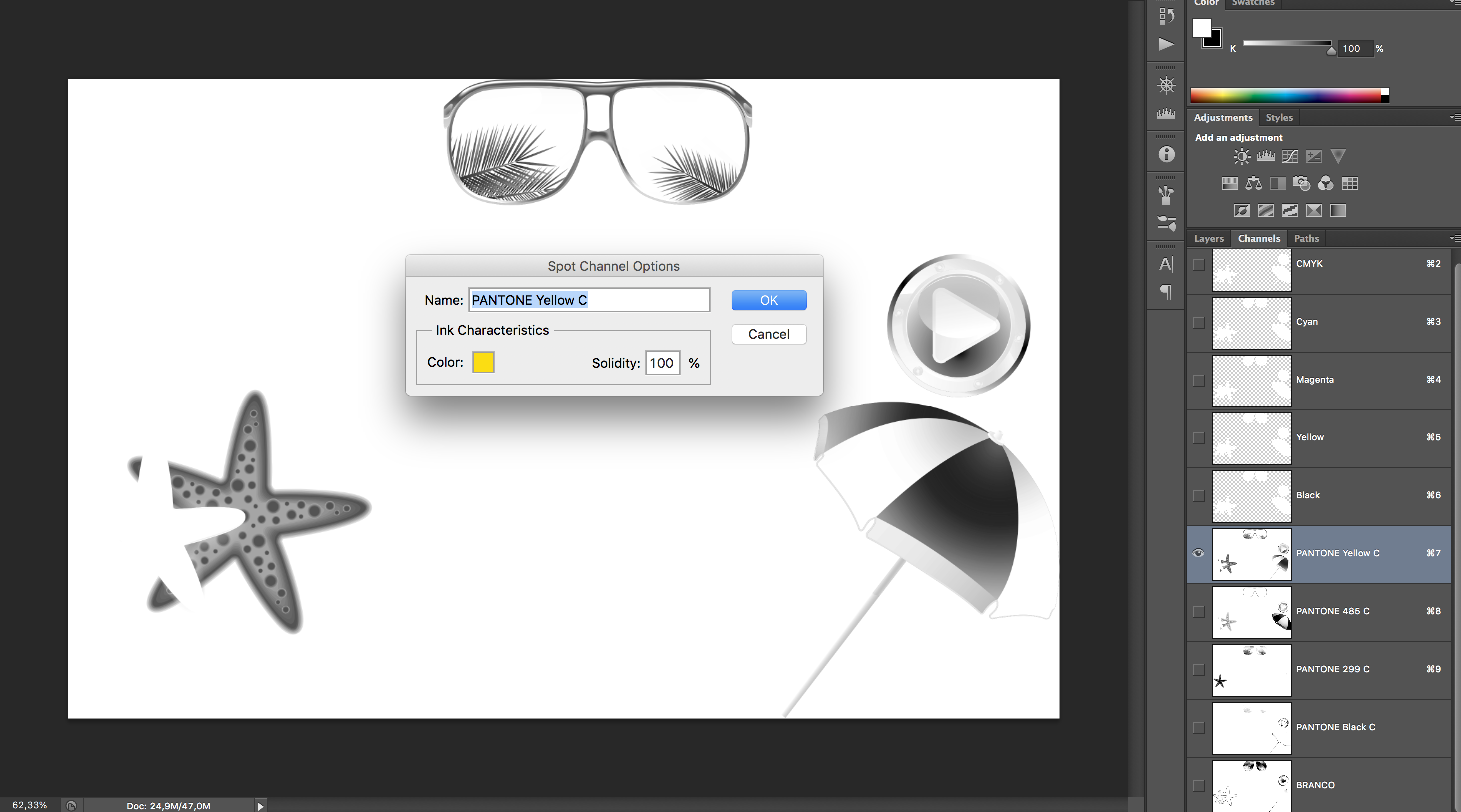

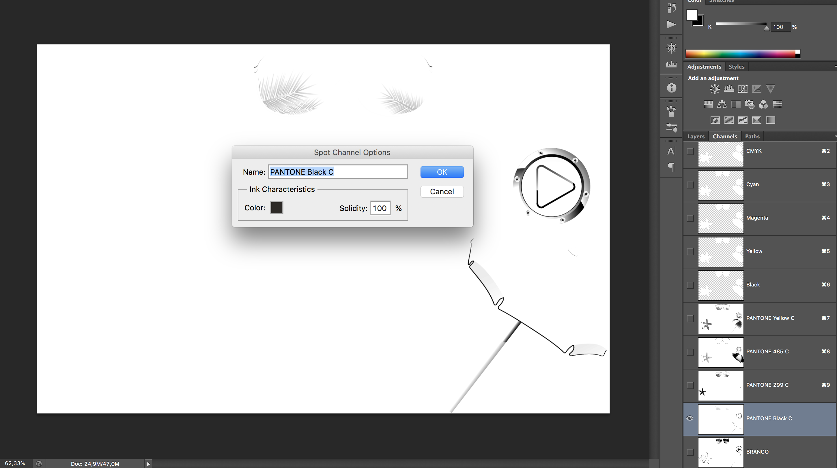

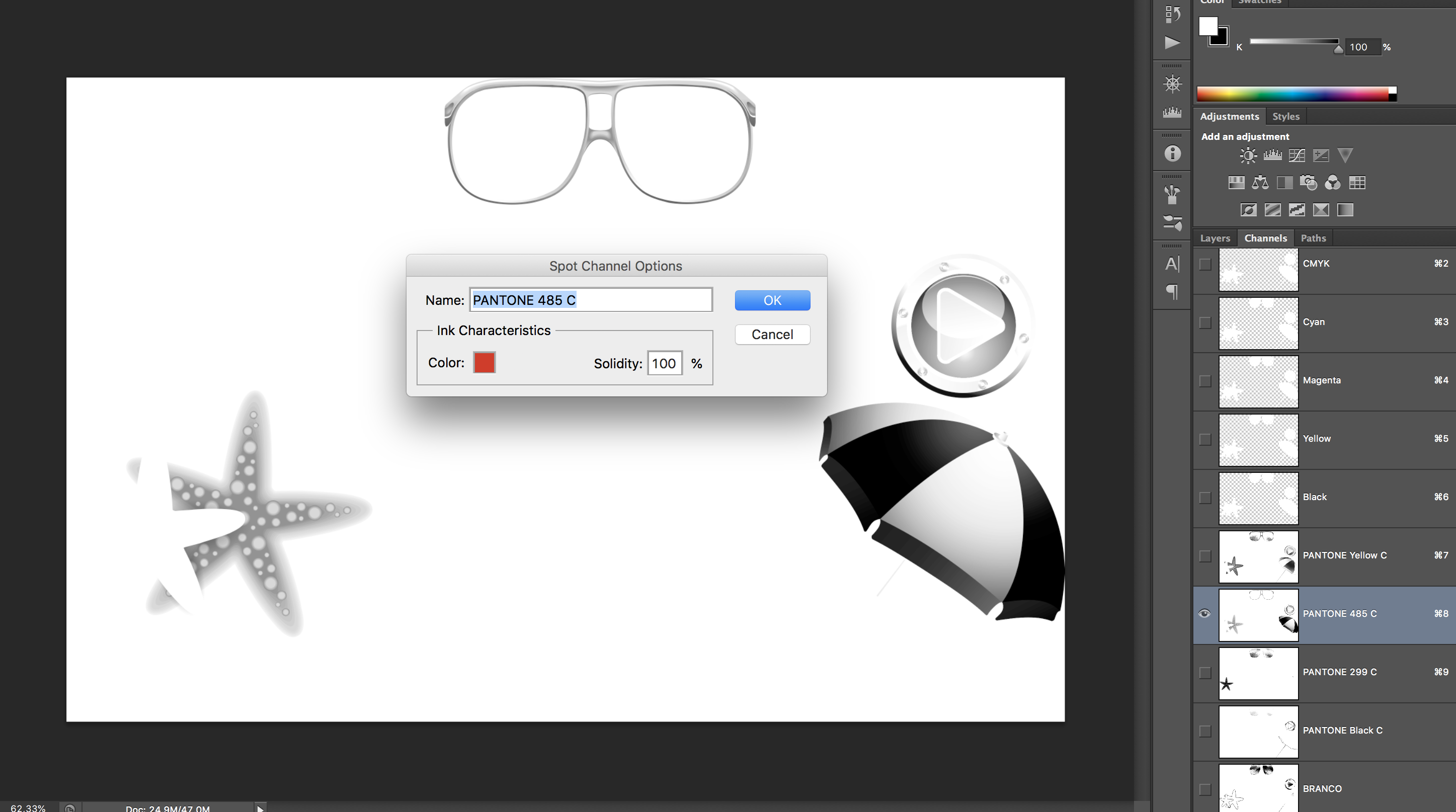

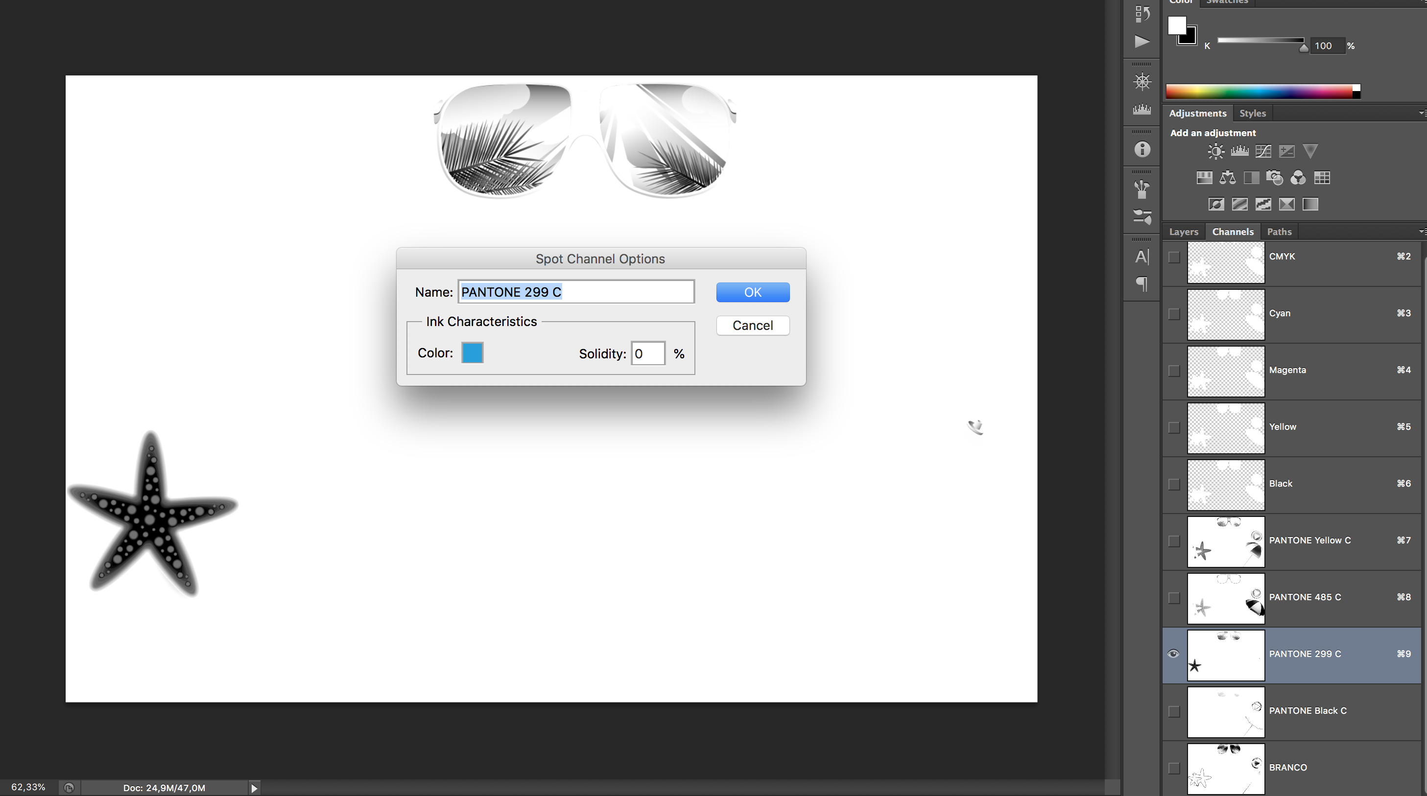

2- And here is: each channel with its correspondent spot color: (how can I reach this? how to use 'apply image' here? and why the pure white on the cmyk channels?)
Thanks for the help!!!
I believe that the white effect on the CMYK is used to toggle a before/after preview on/off when building the spot plates and to also losslessly remove the CMYK from the final image.
An example... The spot red could be made from duplicating the magenta channel as a spot channel with the appropriate spot colour. Then the yellow plate could be added in darken blend to bulk up the channel. Various combinations of source and destination/target channels are used with blend modes, opacity, inversion, c
An example... The spot red could be made from duplicating the magenta channel as a spot channel with the appropriate spot colour. Then the yellow plate could be added in darken blend to bulk up the channel. Various combinations of source and destination/target channels are used with blend modes, opacity, inversion, channels used as masks etc. to add and remove colour. Apply image and calculations are similar tools for such CHOPS (channel operations).
Keep in mind that the “preview” may or may not be anything like the final printed result.

Command click a single process color channel preview to load a luminosity mask. Then make a new spot PMS channel that corresponds that selection. For a PMS Red I would usually use the magenta channel. Then delete the process channels when done, or make a curve adjustment layer on the top that sets CMYK to 0.
Then I run color corrections & calculations to get the tonal values needed. My preference has been to use calculations rather than apply image, but nothing wrong with apply image just seems calculations gives you an extra option for source outside of the final result.

Interesting. I’ll try with calculations too. And when you use either apply image or calculations, you keep visualizing the results n black and white? (just revealing the channel you are working), or there is a way to see it in the real color that you want to achieve?
Copy link to clipboard
Copied
Once you created all spot channels and suppressed the CMYK what you see on a color calibrated screen is actually pretty close to what you will get. The RGB color gamut is pretty big and covers most of PANTONE. The colors you have are also very common and I work with them often 109 & 485. The 299 will look a little more saturated then C&M would have, but I think you will like than even better as most people do.
Teals to me are the toughest to match and the graphic above shows that. You may google and find other Illustrations of this comparison, but in my experience/opinion this is more accurate showing the teals in Pantone having a larger gamut than RGB and especially CMYK, blues and chartreuse also tough to match but not as bad as teal.
I sometimes do not even use calculations, never levels, but curves and channel mixer for this are most useful.

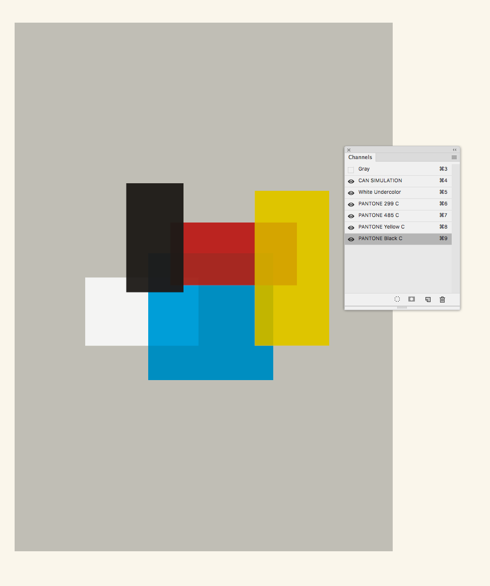

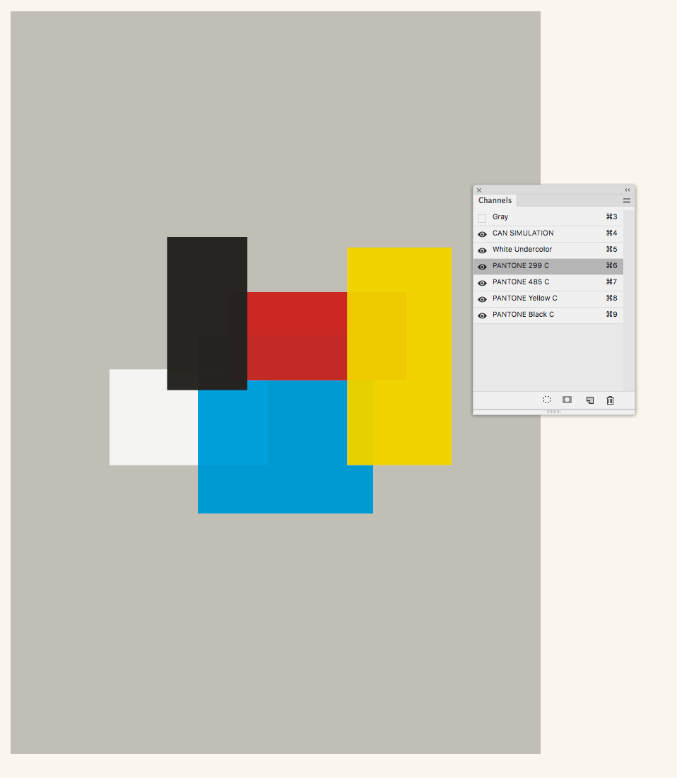

Is the white printing as an under color? If that's the case I would think you would want an extra spot color to simulate the can color, that doesn't get output (you could prevent output via an ink alias over in InDesign), and with the white going down first as another spot ink
Also, the Solidity setting would have a significant affect on the preview—I'm guessing you didn't mean to set 299C to 0%. You would want to talk to the printer about the ink opacity and print order.
80%
50%
