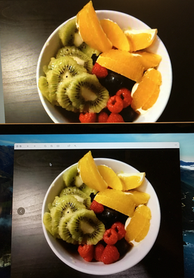

In my Macbook Air, the screen color is yellow tint, so I tried to calibrate the white point.
However, I found that compare to external monitor, the color on Macbook is not that vivid as well.
From following photo you can see: Upper one is external display, the bottom one is Macbook Air,  you can see the "Orange" color is so different. So does happen on other "amber, yellow" colors sets as well.

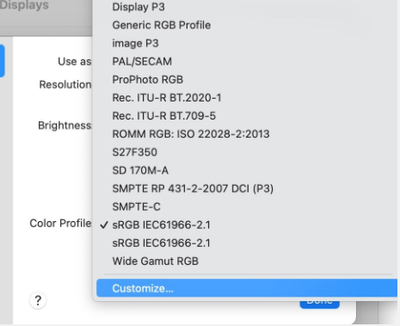

So, on the Macbook screen, I tried to apply a color profile: sRGB IEC61966-2.1, which is using on the external display, it makes the color more vivid - However, the problem is, the whole screen change back to yellow tint again.
From following photos you can see:
Left: After applying the color profile, the color is vivid on the bottom (Macbook) screen.
Right: After applying the color profile, the yellow tint come back on the bottom (Macbook) screen.

1. Select current profile, then click "customize"
2. In the new window, select the profile again, then click Option + "+"
3. Calibrate followed by the steps: select the wanted white point

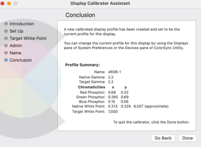

untile this step, the image showing on the screen is perfect: with vivid color (as sRGB IEC61966-2.1 is applying) AND the white point is updated - no yellow tint at all.
Problem:
But then the problem comes in the final step:
4. After clicking "Done", I can clearly notice that, on the screen, the white point is calibrated (with no yellow tint), but, all vivid color saturation, vibrance are gone. It just feels like the new calibrated profile is not on the basis of sRGB IEC61966-2.1.
Please Help:
So, I am here to ask you help, could you please advise how to calibrate or create a new profile on the basis of existing one, only change the white point value?

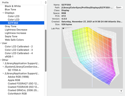

I check in the ColorSync Utility and see the difference between the color space applying in my Macbook and External Display, also tried applying the color profile on my Macbook to External Display then find the color are more closer.
I think that is the main reason why vivid color displayed on External Display.
...So, may I ask, is there a way to just adjust or create a color profile on the basis of sRGB IEC61966-2.1, but only change the temperature / white point?

The Mac "System Profile" is set in the System Preferences / Displays pane. This allows OSX to pass on information about display characteristics to applications such as Photoshop.
The selected "System Profile" should be a display profile [the ICC display profile describes the characteristics of a specific calibrated display].
The selected "System Profile" should not be a working space like sRGB.
On the other hand, above statement is what I am confusing:
As you can see, I have already chosen "S27F350" as color profile in "System Preference > Display", then do a "Calibrate" profile by using the MacOS default under "S27F350" has been applying...but after calibrating, in the final steps, the color space just changed....See this attached video file.

I dont think you've ever explained WHY you are attempting this?
I'm confident that there IS no way to calibrate using that OSX tool based on"S27F350.icc" which seems to be an ICC profile of another type of display.
On Hardware calibration screens such as Eizo, some calibration software can load an ICC profile as part of the target (e.g basICColor display 6 software) its called "emulation".
IF you are trying to make a MacBook screen match a display (S27F350 which is a 27" Samsung Display) then this is not the way to do it. The S27F350 display profile is for use with the Samsung display ONLY.
IF you calibrate and profile both screens using good tools then they will match within their capabilities.
It seems you "like" the Samsing appearance? Colour management is not about what you like its about what's correct I'm afraid.

Let me try to explain why I wanted to calibrate the Macbook display on the basis of other profile (S27F350 in this case), and I think you've almost already get the point.
The root reason is: (in some case I use Macbook standalone without external display)
I don't want the color in photo / presentation files produced from my Macbook looks weird when display in other screens.
1. There is a Display, a Thinkpad notebook in my hand, then last week, the Macbook arrived.
2. After powering on Macbook, I find the screen on Macbook is yellow tint, under same 6500K, it "looks" more yellowish in my eyes. I tired to open a blank web page in same version browser on Display, Thinkpad to compare. So, I "don't like" the color in my Macbook.
3. I started to calibrate it by using OSX default tool, adjust to 7000K, looks better, not that yellowish - while doing this, I find the color in Macbook is not "vivid", as explained in OP.
3.1. I hold real orange, grape, kiwi, raspberry, compared to them on Display and Macbook, the color on Display is closer to what I can feel in my eye. As in OP the first photo you can see, the bottom (Macbook) screen is a little bias to "green tint" and "lighter".
3.2. Example: when proceed a photo, if my eyes are focusing on the window in Macbook screen, based on it to proceed some portrait after doing sports, adjust the face color to "skin yellow" + "red", then move window back to Display, the color on the face will more darker, looks like "brown" - which is weird and not natural.
3.3. Take this page as an example, from what my eyes can feel:
the background color of top banner is in between "Cobalt Blue" and "Stained Glass Blue" seeing from Display, but when seeing from Macbook, it's a little "purple" bias, much closer to "Stained Glass Blue" (image from lifewire webpage). So if some times I proceed presentation while travelling with Macbook only, when I adjust a "Cobalt Blue" seeing on Macbook screen, what is the color will be look like?
4. To avoid 3.2. happen, and on the basis of comparing color from real fruits in 3.1., I wanted to apply profile S27F350 onto my Macbook screen. However, after applying it, the screen back to "yellowish" again.
As a result, I wanted to calibrate the white point of Macbook screen on the basis of S27F350.
So, I have no idea what I can do to avoid 3.2., or 3.3. happen, which means not to export weird color if it is seeing / feeling correct in my eyes from Macbook screen.
Shall I just return my Macbook and get a new one without "yellowish screen" issue, then applying S27F350 profile? Or everytime, I need to "pick" the color code in PS to get the absolute value of a color?
I am not that professional on design and taking photos, so, just wanted to avoid weird color exporting and closer to natural will be fine.
Thanks for your inputs, time on discussing and following up.

I'm afraid that comparing an actual fruit to an onscreen image of it tells you nothing about correct setup.
For that test of accuracy after calibration and profiling - you need something like this http://www.colourmanagement.net/products/icc-profile-verification-kit
It goes like this: -
The fruit is photographed.
The camera or the raw processing software has an ICC profile - that is what sets the RGB colour of captured objects. The camera profile (or [after conversion] a working space profile like Adobe RGB) is embedded in the image.
It seems you "like" the appearance on the Samsung display. Unfortunately, that opinion is entirely irrelevant to a colour managed workflow.
What you need is a CORRECTLY calibrated and profiled display screen [could be your Samsung, could be the Macbook, could be both] - and then if [when working the calibrated profiled screen] you don't like the on-screen match to reality - you will adjust images using Photoshop 'til the match is to your satisfaction.
We don't use colour management to provide a match to a liked device (although good input/camera profiles do help with matching of captured items] we use colour management to provide us with a REAL view on images so we can adjust them WHILST VIEWING ACCURATELY.
That way, if you send images out to a client, or to get prints, the other persons colour managed screen will show the same image appearance.
[By the way, a display screen should be viewed in rather subdued light, objects [your fruit] (and prints) should be viewed in good daylight. SO unless you have a daylight 'light booth'* you CANNOT hold up items next to the screen and look for a match. IF the light it bright enough to illuminate an object, then its way too bright for proper viewing of the display screen.
