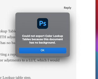

I'm here because I keep getting the "Could not export Color Lookup Tables because this document has no adjustment layers". However, I DO have an adjustment layer, WITH adjustments. At one point I was getting "Could not export Color Lookup Tables because this document has no background layer".
I want to use a LUT to correct colors in a simple video by exporting a representative frame of the video as a png, editing it to taste in Photoshop, and then exporting the color adjstments to a LUT, which I would subsequently import in to into a LUT in Final Cut Pro.
Can't do that becauase I'm having an issue at the export as Color Lookup table step.

Sep 28, 2021 Sep 28, 2021
This is the adjustment that I was trying to make. It's a video that was shot in ffron of a computer, so the colors had a blue hue. I used levels to make the colors look more natural. I finally got something that look realy nice. I just used a scrap shot for the levels adjustment.
After I got the color close enough to where I need them to be, I went to fiule-> export -> color lookup tables
I got the following dialog box. I mustbe missing a step (or two)!

Well, the alert states there is no Background Layer and there is none, so what is the problem?
If one changed a Background Layer to a regular one (or otherwise created a file without one) one can change a plain Layer to a Background Layer via
Layer > New > Background from Layer

Community Beginner ,
It's an adjustment layer, and I used levels to bring warmth to the colors. Image posted above.
Sep 29, 2021 Sep 29, 2021
NOTE - This was sutosaved fron yesterday at approx 7:30 pm Easten.
SOLVED!
I went to the Layer menu, and chose New-> Background from Layer! After that I was able to export my LUT! Thanks for your time and consideration!
BTW, after I do that, that particular option in 'Layer -> New' changes to "Layer from Background". So you can change it back if you need to!
