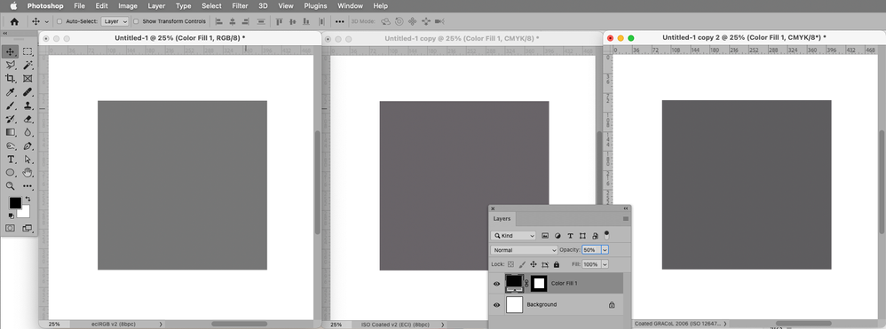

To illustrate the absurdity of expecting CMYK transparency to provide identical results as RGB transparency I like to use the example of black at 50%.
RGB (additive color) has true black, CMYK (subtractive color) does not.
And that doesn’t even take into account the Total Area Coverage limitations in the various CMYK Spaces.

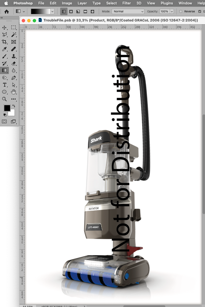

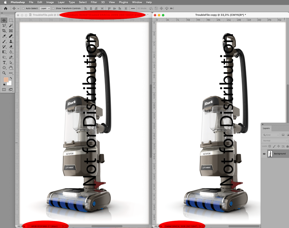

It seems to work fine on the image (see the difference in the blue »rollers«), but the transparency issue is another matter.

I tried various edits, in both RGB and CMYK and had the best results after conversion to CMYK, using selective colour on the reflection layer – reducing magenta in blues.

@Stephen Marsh clearly stated that you should flatten the image on conversion – did you do that?
