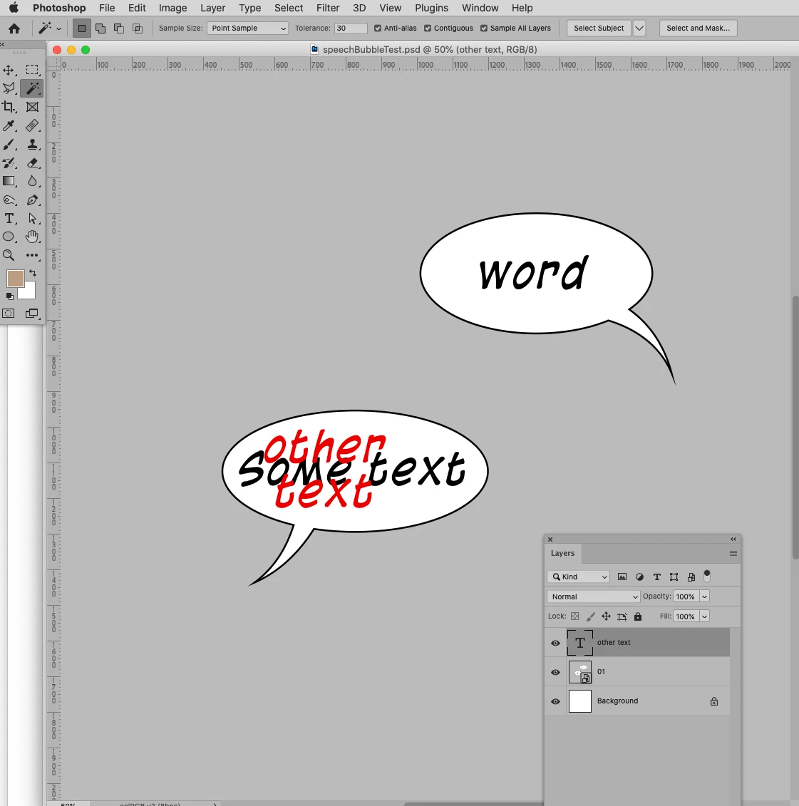

Hello, I work as a comic editor and my job is to put translated text in the middle of the dialogue bubbles. My files sometimes have built-in text layers or not, sometimes they are rasterized layers. To turn off all rasterized text is really annoying, because they usually don't arrange in a certain order, and there are hundreds of layers.
So I usually use magic wand (all layers mode) to select the boxes, then modify the selection and fill them at new layer (I recorded this action so it's alright).
It takes quite a while to select each bubble one by one. Is there a way to automatically get the selection outside a text layer using magic wand script? I could play it after setting the text and use the selection for aligning, too, or to handle broken dialog boxes like this:
Correct answer c.pfaffenbichler
Please try this.

December 18, 2022
Wow, this worked to me! Thank you very much!

November 28, 2022
I fail to see Type Layers in your screenshot, could you elaborate on the actual process you have in mind?
December 2, 2022
Thank you and sorry for my late reply!
There is no type layer in my screenshot, they are rasterized layer which arranged in no order. Each comic page has hundreds of different layers like that, most are rasterized (including speech ones) so it's hard for me to find and hide all of them. I usually fill the speech bubbles on a new layer - using the magic wand to select the bubble's color (outside the text, within the bubble) and some action to make sure to fill the whole bubble. But I would sometimes use THAT selection for aligning the new text, too. So all I need is just a script, or an action to select the area within the bubbles below the selected text layer, so that I can skip the area selection step with magic wand.
Maybe this is a difficult thing, but I think this request is not too much. Thank you very much if you can help!
c.pfaffenbichler
December 3, 2022
I don’t fully understand the process you describe, please post meaningful screenshots to illustrate the steps.
