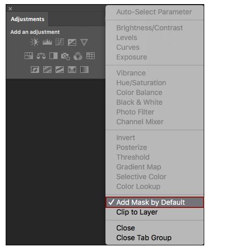

Photoshop’s default behavior is to add a layer mask whenever an adjustment layer is created. You can however use the fly-out menu on the Adjustments panel to check/uncheck “Add Mask by Default” to toggle this behavior. Other than that you can also visit adobe website for this.
This option is only for the situation when you don't have active selection: Then you can choose whether you want empty mask added to adjustment layer or not, but in case you have active selection, mask is always created and you loose selection
