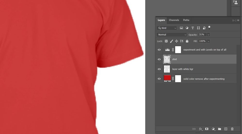

I just downloaded your example image.
You may be able to do trick using transparency.
Before using Transparency separate shirt from background, unlock background layer or promote it to normal then select shirt and press  Ctrl + Shift + J. Lower transparency of layer with shirt to 25% for example, experiment. Create at the very bottom layer filled with color and experiment. remove bottom most layer when you finish experimenting.
Save as PNG.

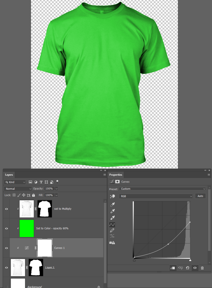

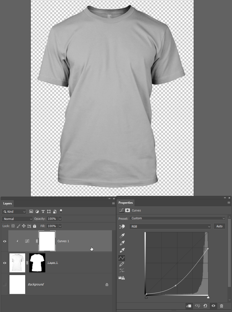

I'm going to guess that you want to use the same image of the t-shirt and show it in different colours.
Colorizing does not work on objects that full white or full black.  In fact it has the most effect on 50% grey.  So we need to use something like a curves adjustment layer to achieve that.  Note that as well as bringing down the white tones, I have also applied a dip in the middle of the curve to darken the shading.  I have also clipped the curvesa layer to the t0shirt layer.
Now we can add a layer, fill it with colour and set its blend mode to colour.  It was too intense so I reduced its opacity to 60%
To increase the shading effect we can use a copy of the t-shirt set to Multiply.  Not I have pulled down the curves layer a bit more for best effect.
Let us know if we are off the track, giving as much inforation as you can.

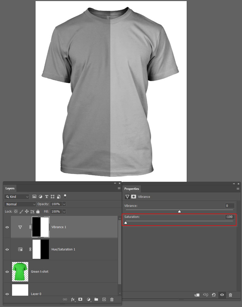

I'll add this recent video from the Photoshop Training Channel on transfering shading to composited elements.
Jesus Ramirez nearly always has information that is new to me, and that information is often hugely effective and changes the way I use Photoshop.  In this case I discovered that desaturating using a Vibrance adjustment layer has an important difference to using Hue Saturation.  To make that clear, I am referring to using the Saturation slider and not the Vibrance slider in the Vibrance adjustment layer.  You can see a marked difference in the results.  Desaturating with the Vibrance layer on the right has produced significantly greater contrast making it much better for transfering its shading.image.png

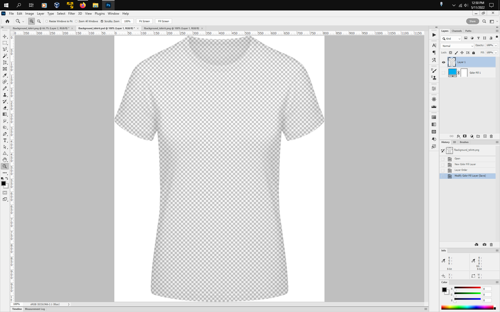

Basically i used Blend-If  to get the below:
screenshot of what the above png looks like photoshop with the color fill layer below it
with color fill
If that looks like what your after i'll go into more detail

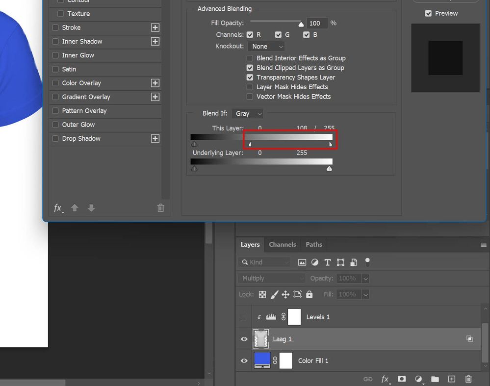

Try splitting right handle on This Layer using Alt + click and drag as on screenshot below. You must isolate shirt on separate layer to use Blend If as suggested below.

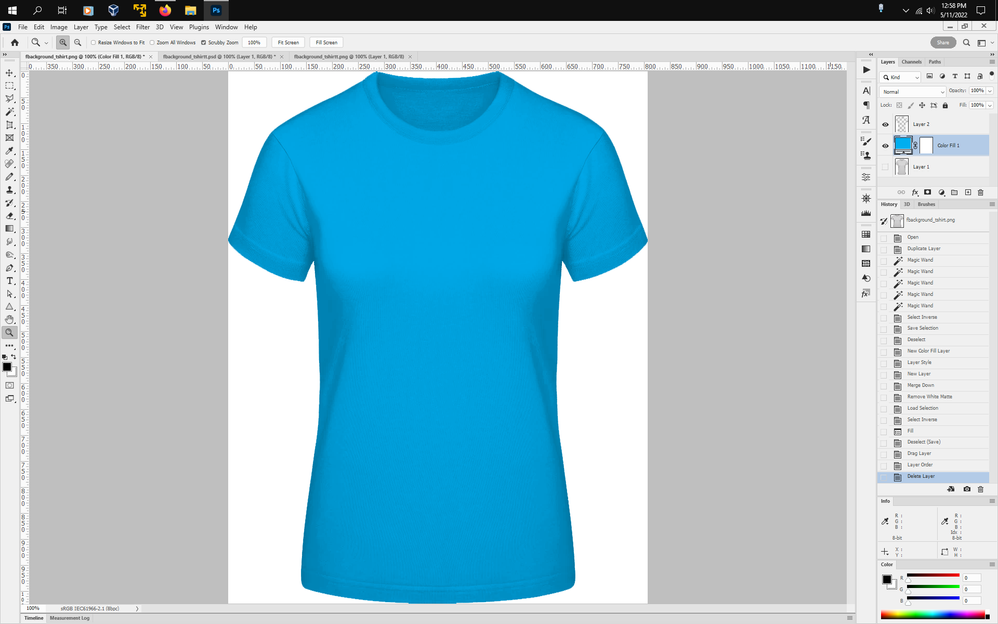

May 12, 2022 May 12, 2022
Like this:
1. Duplicate the shirt layer
2. make a selection of the shirt by using the magic wand and clicking on the
    white area around the shirt
3. save the selection to a channel for future use, then Select>Deselect
4. select the bottom layer and add a color fill adjustment layer with black as the color
    (Layer>New Fill Layer>Solid Color)
5. select the top shirt layer and go to Layer>Layer Style>Blending Options
6. move the right This Layer slider to the left just enough so see black around the shirt, the
    hold down the Alt or Option key and click on the left part of the slider to split it and move
    it all the way to the left
7. go to File>Scripts>Flatten All Layer Effects
8. go to Layer>Matting>Remove White Matte
    (the image should turn black)
9. change the color fill layer to another color other than black
10. select the top shirt layer and load your saved selection from the
      channel you saved earlier
      (Ctrl or Cmd click on the channel in the channels panel to load the selection)
11. Go to Edit>Fill>Contents>White
12. Select>Deselect
13. turn off the visibility of the bottom two layers and File>Save As>PNG with
      smallest file size
      (click on the eye to the left of each layer thumbnail in the layers panel to turn
       off the visibility)
