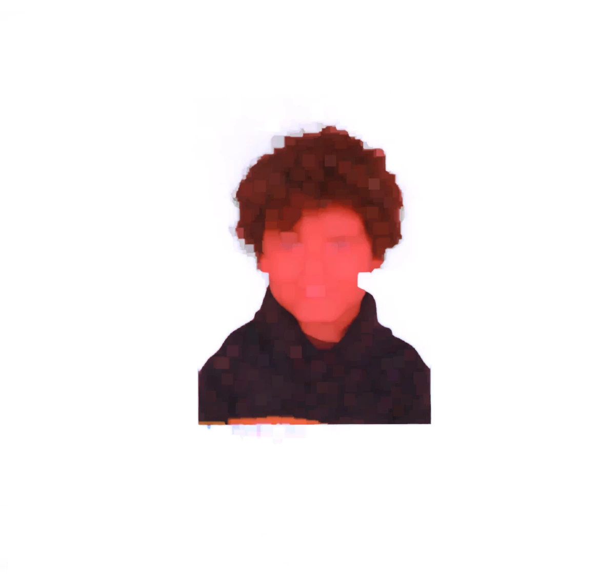

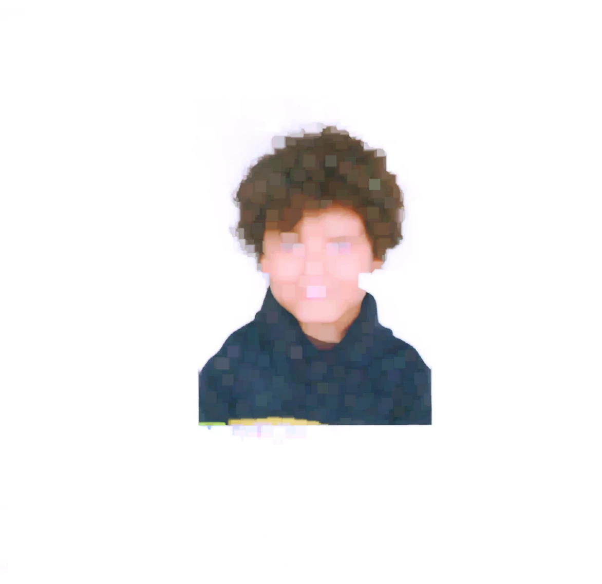

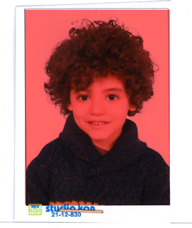

MAXIMUM_RADIUS specifies the radius with which the Filters -> Other -> Maximum filter is applied. The goal I'm aiming for is to clear the image of garbage and frames.
Source frame:
frame after Maximum filter with radius 22
Next, on this cleaned image, the script executes the command Select -> Select Subject:
Then the script tries to align the image, for this it increases the selection box by the number of GLOBAL_OFFSET pixels in each direction. After that, the image is  transformed by the Crop and Straighten filter:
Then I re-execute the Select -> Select Subject command and increase the selection by HEAD_OFFSET pixels up to provide free space above the head and finally crop the image within these boundaries:
That is, you can change these three constants yourself to achieve optimal results (however, it is difficult to guarantee that in 100% of cases the script will perform its task correctly).
