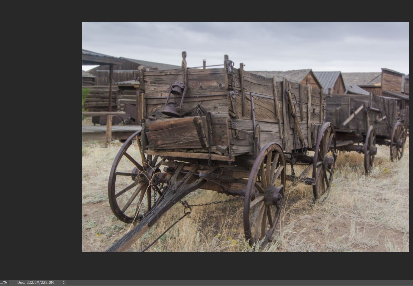

A 16-bit file with the dimensions you mentioned at 25 ppcm will be 222 MB. See screenshot.
You do realize that this will print at approximately 2 x 3 meters with very bad quality?
A4 is 297 x 210 mm, or 29.7 x 21 cm.
Also note that ppcm is not commonly used, it's better to use ppi (pixels per inch), which is the industry standard.
For a high quality print, you will need somewhere between 180 and 300 ppi, depending on the size and the printer used.

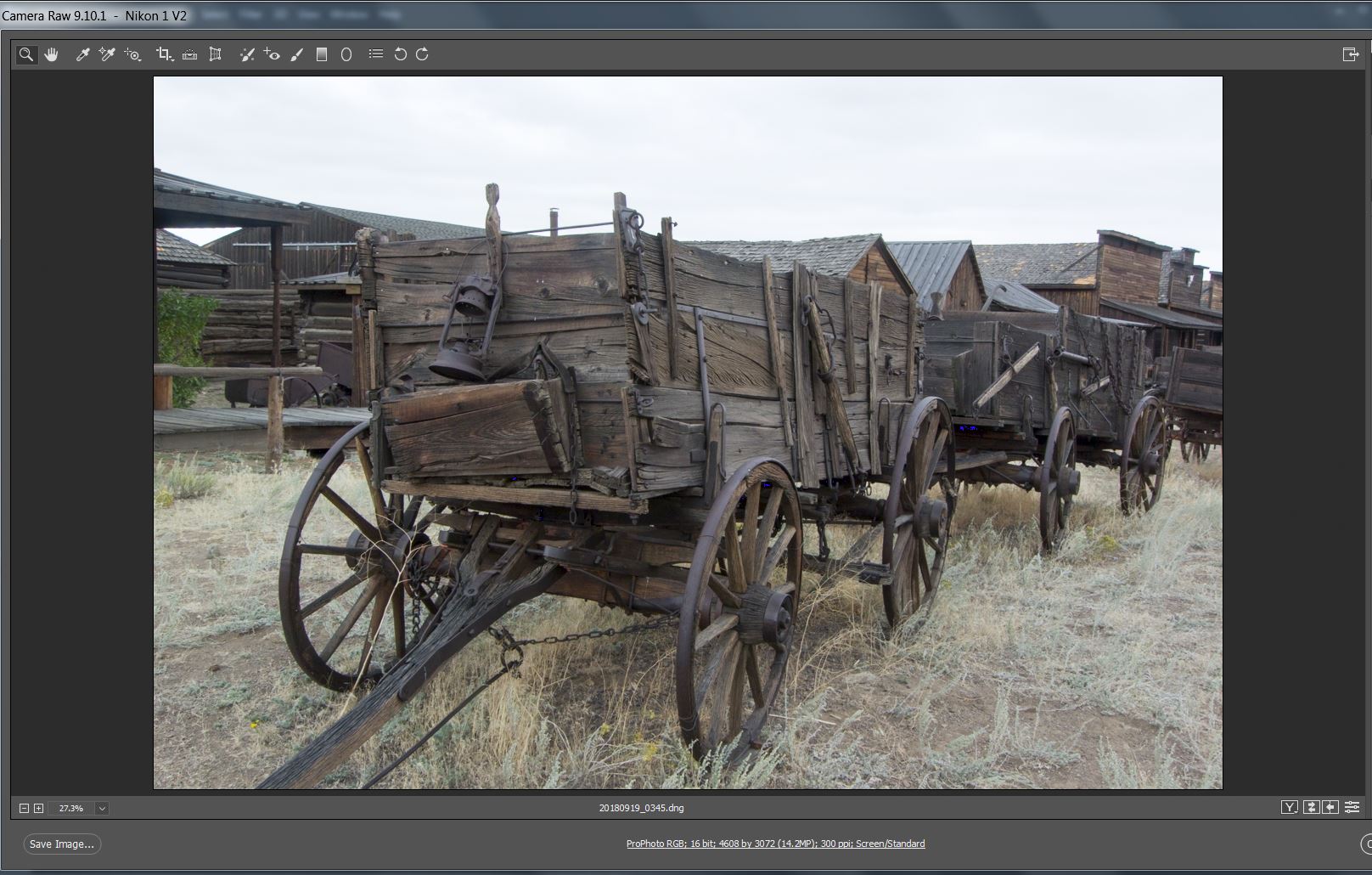

ss5.JPGSS6.JPGss7.JPGHi Chuck, Joseph and JJ
Thanks for your reply
I've edited another photo with SS's .....Hope this helps (all of us!)
Photo brought in
Adjusted in Raw
New Here ,
Nov 07, 2018 Nov 07, 2018
Sorry about that.......snipping is not my forte.
1,2, and 3 should be 5, 6, and 7
What I have done is
SS4     Import
SS5     Adjust in Raw
SS6     Open in PS
SS7     Adjust in PS
SS1     Crop Screenshot
SS2     Result of Crop
SS3     Adjusted in Image
