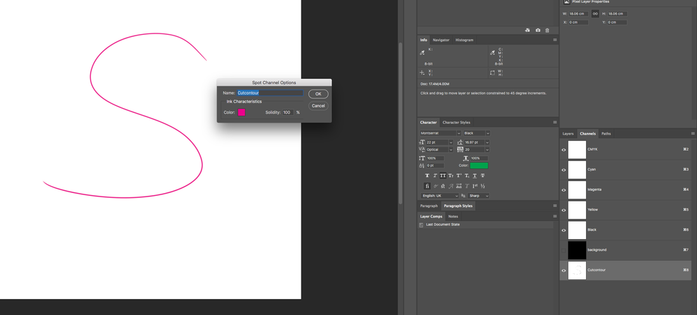

Advisor ,
Dec 20, 2022 Dec 20, 2022
@gener7 Sorry but thats is not true, perhaps you just dont have the knowledge yet. Its is possible to work with spot colors in Photoshop. You can add a spot in the Channel tab, it does work a bit different vs the other apps.
You basically need to make a selection of your pixels which need to get assigned a spot color. Then fill the selection in that channel. It has been in Photoshop for years actually
Though something is about to get changed though. I find this a very strange road Pantone is taking. My bet they make even less money using this approach.
Here's a link with the info about Pantone weird business move and also info on how to work with Spot color in Photoshop.
https://helpx.adobe.com/photoshop/using/printing-spot-colors.html
