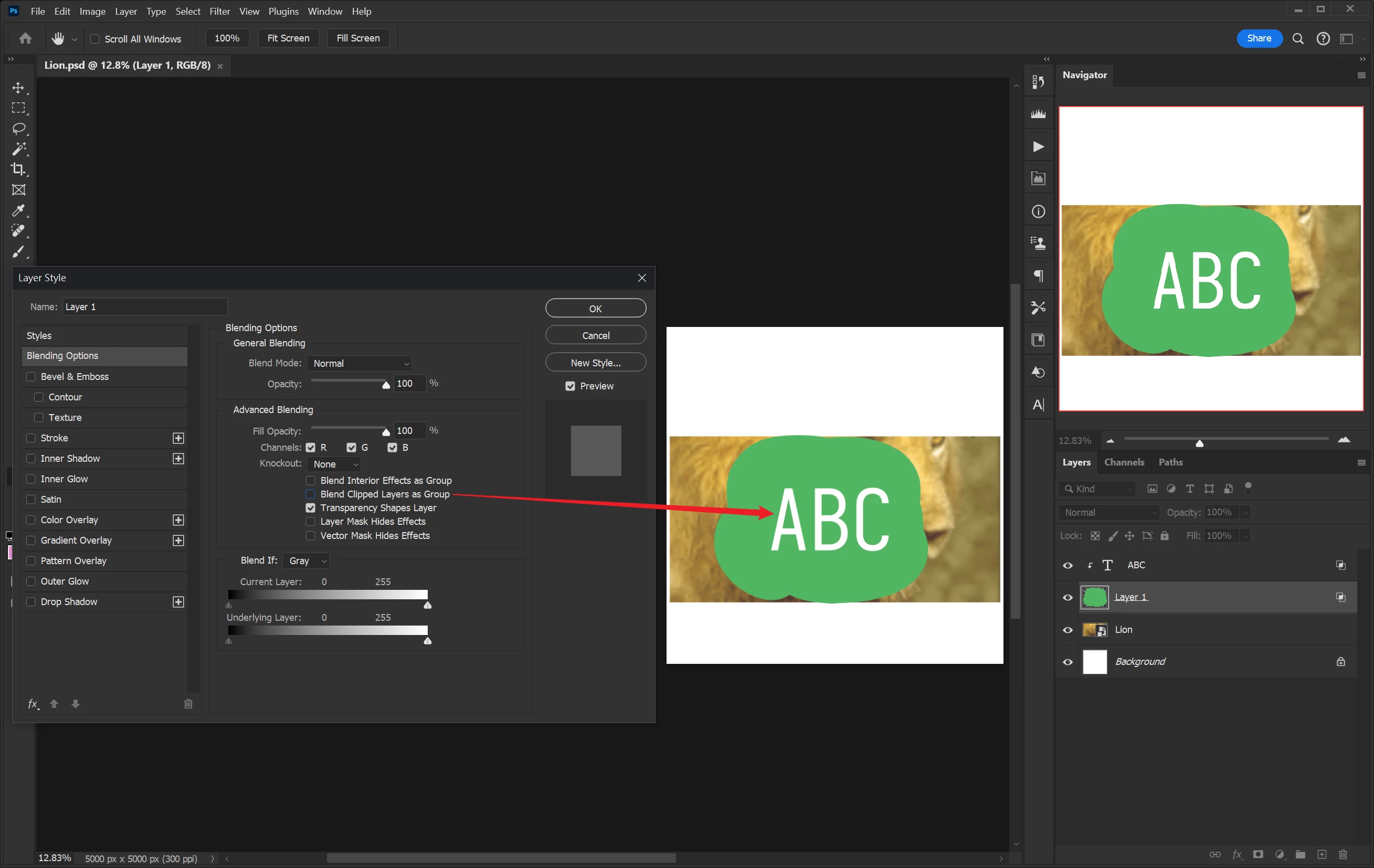

Correct answer fmnijk
Thanks, I can get it to work now. I found that in your picture, "Blend Clipped Layers as Group" was unchecked. That's it! Problem solved. It's not a bug. The Photoshop website's help doesn't provide that information.

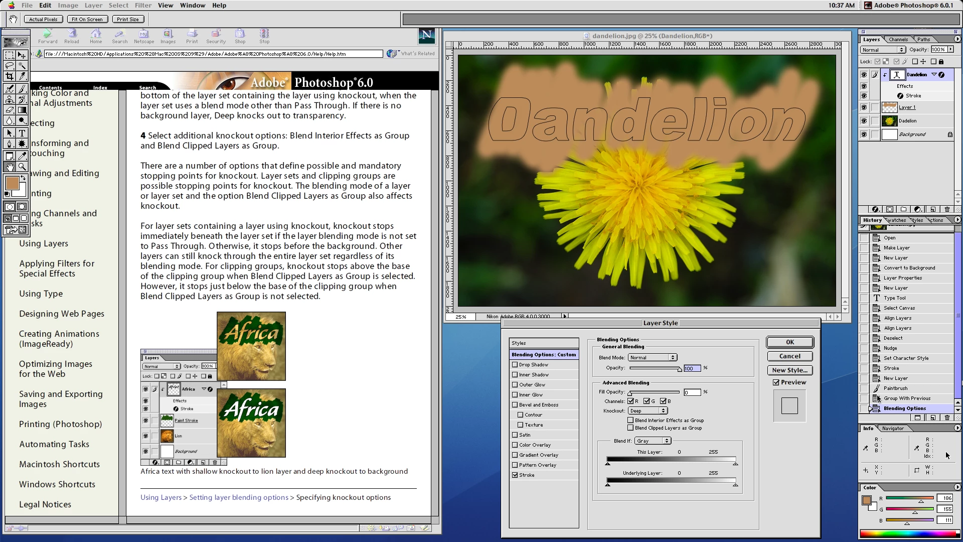

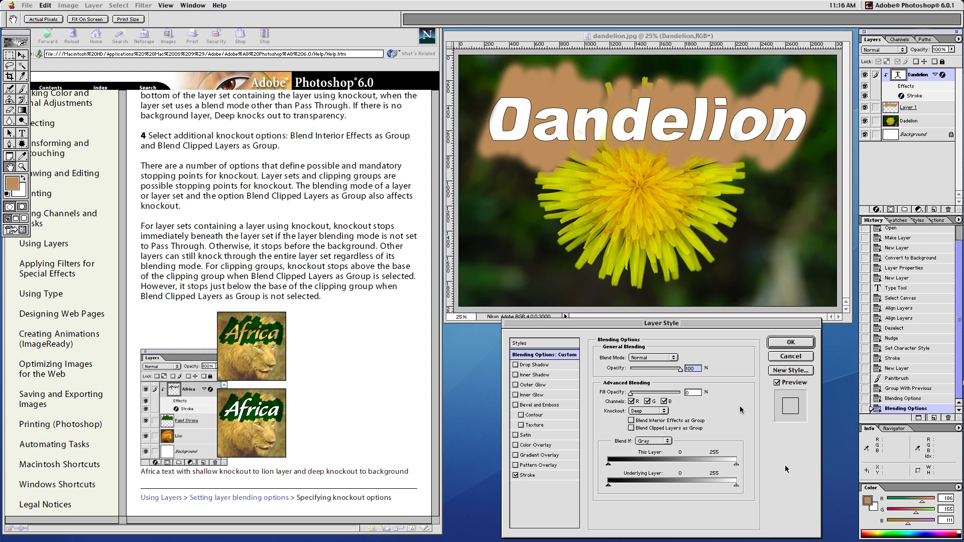

May 30, 2024
In the Photoshop 6 help it clearly shows a picture of what your talking about and even seems to state same in the text, but i can't get it to work in any Photoshop version i've tried.
In the example, the Dandelion layer should punch through to the white Background layer according to the directions, however it does not.
Edit
After unchecking Blend Clipped Layers as a Group for both layers in the Clipping Group it works a descriped in the ps6 help.
fmnijkAuthorCorrect answer
May 31, 2024
Jeff Arola
May 31, 2024
Yes i had also looked at several books and none of them mentioned that either.
So it seems all the layers in the clipping group need to have "Blend Clipped Layers as Group" unchecked.

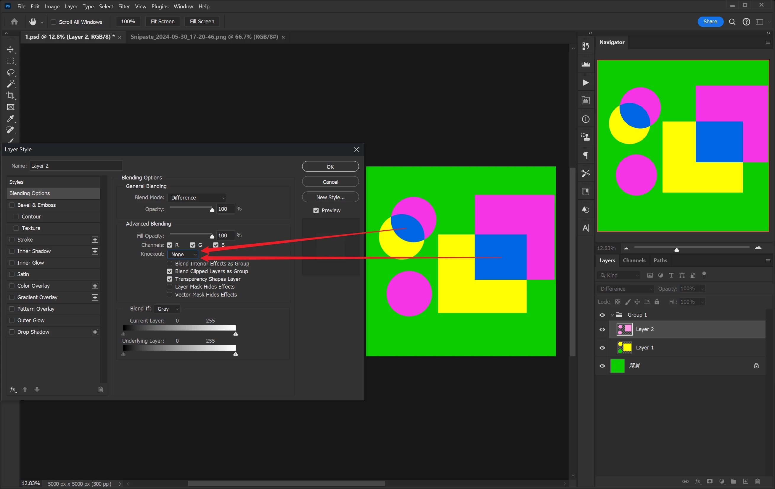

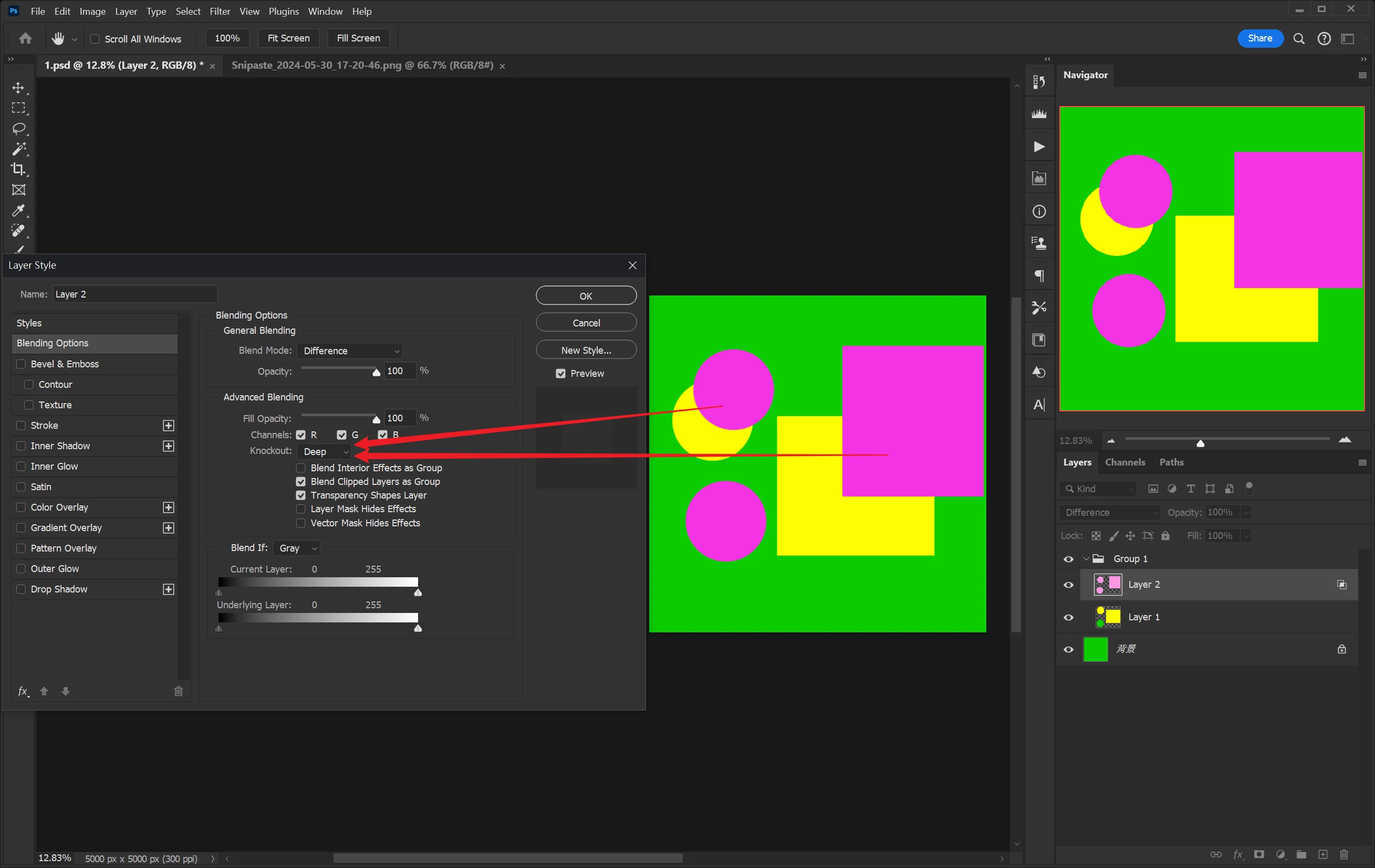

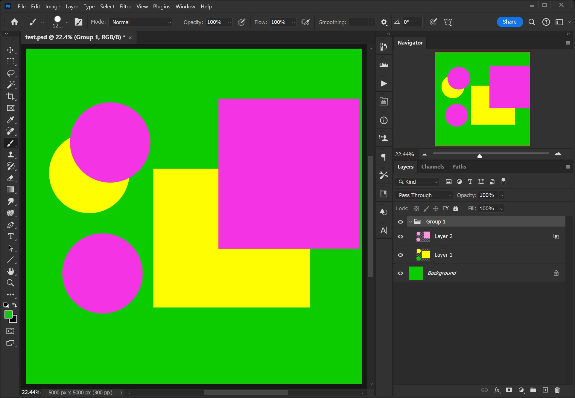

May 30, 2024
Does your Photoshop have this bug?
Here is the image. As you can see, the deep knockout works fine with a layer group but doesn't work with a clipping mask.
Because I selected the deep option, it should knock out to the Background layer. So, I imagine the result will be like the picture I made manually below.
I am using Windows 10 and Photoshop 25.9.0
c.pfaffenbichler
May 30, 2024
Could you please post meaningful screenshots that include the Blending Options-window?
Why the Blend Mode »Difference«?
I don’t understand your problem, though; the intended results does not seem to involve any knock out-effect but just a Clipping Mask-arrangement.
