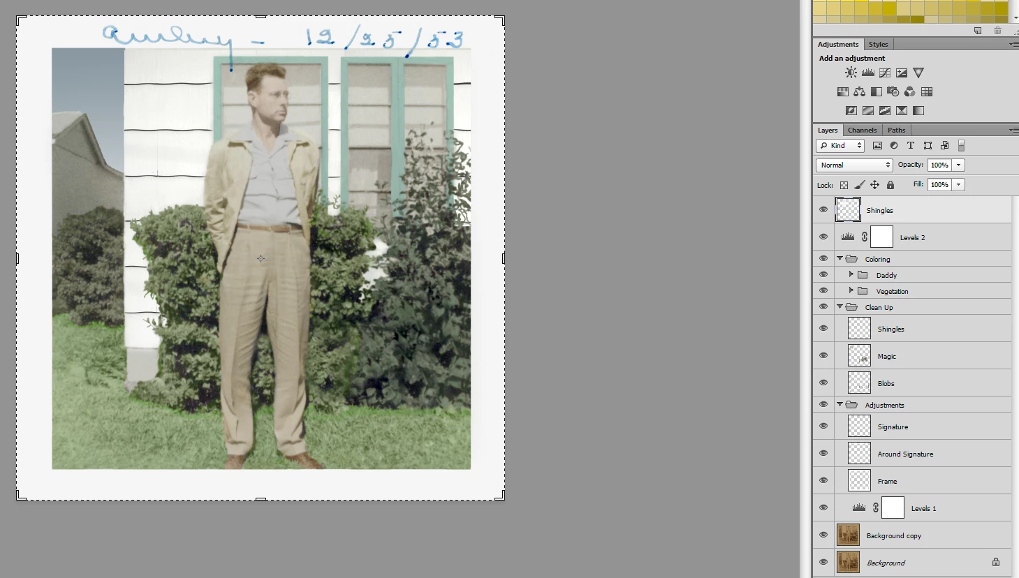

I have Photoshop CS6 v 13.0.1 x64 on a PC running Windows 10. I am restoring (very amateur level). I make a duplicate of the background layer so I can always have my original. Then go through a series of adjustment layers (levels, threshold, etc.). My next step is to usually select the frame of the photo which is usually yellowed with shadows where tape was applied, etc, save it as a selection and then create a blank adjustment layer. In the past, I have been able to then use my eraser tool with the blank adjust layer selected and it would erase what I needed and it would show up. In the image below, I could click the frame layer on and off and it would show what I had and had not erased.
It quit working and I either read somewhere or saw a tutorial that I needed to change some option on the eraser tool that would allow it to erase on all levels below it. When I changed that setting, it started working again. I have the correct layer selected, so that is not the problem. It is that setting that I am looking for and can no longer find. I have exhausted my searching capabilities on the Internet, Adobe Forums, etc. Can ANYONE please help me re-locate that setting so I can use my eraser tool like I did before. I will be glad to share any additional information you need. I do not want to use layer masks or anything like that. I just want to be able to use my eraser on that empty adjustment layer and have it work the way it used to.

    It isn't only the frame that I want to do adjustments on and by using the adjustment layer, it doesn't actually erase the pixels on the image. If you had the ability to click on that layer and turn it off, you would see that the actual image is unaffected. See the image below.
    By using a blank adjustment layer, I was able to get rid of all the blobs of ink on the photo by creating a blank adjustment layer and using various tools (healing brush, stamp tool, etc.). I don't understand HOW it works, but I know it does. I have done dozens of photos this way. When you turn the adjustment layer off, the image looks exactly as it does now, but when you turn the adjustment layer back on, the adjustments I made are there. See below:
    I wish I could explain it better so you would understand. This is the only way I know how to make all the corrections I need to make to the photos without altering the actual pixels. If you were able to turn off the top three layers, you would see the photo is totally untouched. I don't think masks will work for all the different corrections I need to make, but as I said, I am an amateur.

    At least, you seem to know what I am talking about. No one else does. Unfortunately, that option doesn't exist, but that is what I am looking for. This is a screen shot:
    I clicked on the eraser options at the top, but it only gave the option to select whether it was chisel or pencil. There was a setting option, but nothing about it working on all layers. It is so frustrating because I know for a fact that there is some setting that allows me to erase on a blank adjustment layer without affecting the actual image, but I can't locate it again.
    sharona68226444
    June 29, 2018
    I found what I am looking for under the stamp tool. If you look towards the end, there is the word "Sample." If I click on that, it gives me the option for current layer, current layer and below and all layers. When I turn on all layers, the stamp tool acts the way I want the eraser and other tools to work on the adjustment layer. However, that option is no longer showing up for the eraser tool. Don't know if that helps.
