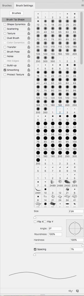

Another solution is to make a new brush for use with the eraser tool, go to Brush settings, and uncheck the 'Transfer' box. For examples, I have a brush with Roundness 100%, Hardness 100%, Spacing 1%, and the only box ticked under Brush Shape is the Smoothing box. That did the trick for me without having to alter my Wacom settings. (Photoshop CC 2018)
