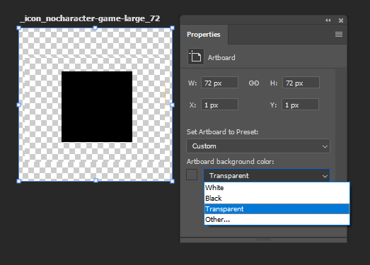

Why do I keep getting white backgrounds and not transperent png's?
New Here ,
Feb 11, 2020 Feb 11, 2020
I had the same issue creating a transparent background and I found a solution! 🙂
When creating an artboard, go to its properties window and select transparent background!

Feb 22, 2022 Feb 22, 2022
This made the difference to me, clicking off the trim layers, worked well after that

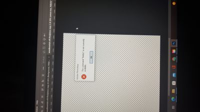

Hi when exporting layers to files it suddenly stops and comes up with these errors messages ?
Can someone please help
Feb 27, 2022 Feb 27, 2022

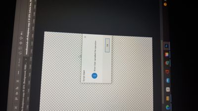

New Here ,
Hi , when exporting layers to files i keep getting this message come up, how do fix this.
Thanks
