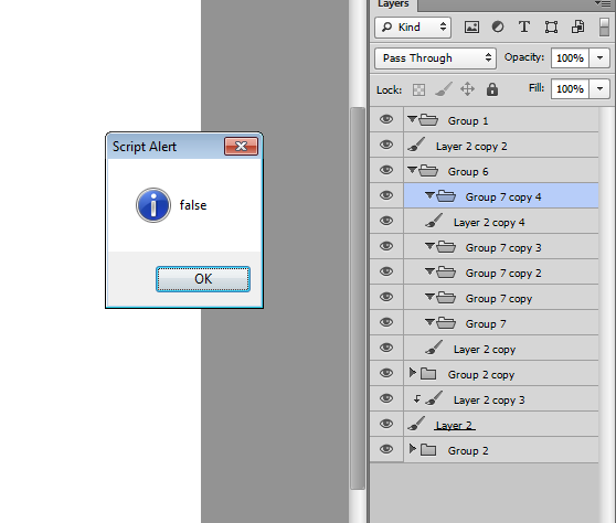

@Kukurykus: maybe I didn't understand how to use your code in my script but Photoshop 6 tells me that sTT is not a function.
@c.pfaffenbichler: interesting but:
- Key 13 is "layerLocking: DescValueType.OBJECTTYPE
[ActionDescriptor]_layerLocking", even the layer is locked or not
- can't figure how to know if the layer is a LayerSet, or if its parent is a LayerSet.
As I really don't understand these deep codes, maybe another solution would be to have a reference to the current layer (at the end of the loop), so I could use:
lyr.isLayerSet = (layerRef.typename == 'LayerSet');
lyr.isLocked = layerRef.allLocked;
So, how could I have a layer reference from the initial code?

Jun 09, 2021 Jun 09, 2021
»- Key 13 is "layerLocking: DescValueType.OBJECTTYPE
[ActionDescriptor]_layerLocking", even the layer is locked or not«
Yeah, one needs to »go deeper« when one wants to get the values from inside ObjectType – which @Kukurykus ’ line of code
dsc.getObjectValue(sTT('layerLocking')).getBoolean(sTT('protectPosition'))
illustrates.

@Kukurykus In order to know if a layer is inside a group or not, I tried to get the parent's name from the desc, using "PrNm" without success (I checked keyParentName exists in Photoshop CS6 from CS6 SDK). Any idea of how to retrieve this information?
I guess I should look "deeper" in one of the desc item, as c.pfaffenbichler said, but I don't know how.
LEGEND ,
Jun 12, 2021 Jun 12, 2021
People's Champ ,
quote
Getting layer's parent using ActionManager
By @Kukurykus
It seems that the code does not work correctly if the target layer is a folder.
Here, you can play around.
LEGEND ,
That's right, I noticed it too. But both of them wanted to know if a layer is inside of group 🙂
People's Champ ,
REM:
"parentName" and "parentIndex" refer to Actions.
The "parentName" for an Action is the name of its ActionSet.
This has nothing to do with layers.
LEGEND ,
Contributor ,
Jun 13, 2021 Jun 13, 2021
Thank you. Didn't think it was so complicated!
LEGEND ,
No, it's quite easy:
function lS() {
	return (s = typeIDToStringID(executeActionGet(ref)
	.getEnumerationValue(sTT(ls = 'layerSection')))
	.split(ls)[1].length - 7) + (!s ? 0 : 3)
sTT = stringIDToTypeID
bL = (lrs = activeDocument.layers)
[lrs.length - 1].isBackgroundLayer;
(ref = new ActionReference()).putEnumerated
(sTT('layer'), sTT('ordinal'), sTT('targetEnum'))
indx = (dsc = executeActionGet(ref)).getInteger(sTT('itemIndex')) - !!bL
lvl = lS() + 1; while(lvl && indx > 1) (ref = new ActionReference())
.putIndex(sTT('layer'), --indx), lvl += lS(); alert(!lvl)
People's Champ ,
It's right?
LEGEND ,
Later I reminded myself to include background layer. The code is corrected. Check it again 🙂
People's Champ ,
LEGEND ,
That's little oversight of undefined, as I forgot to use double exclamation mark before bL 😛
