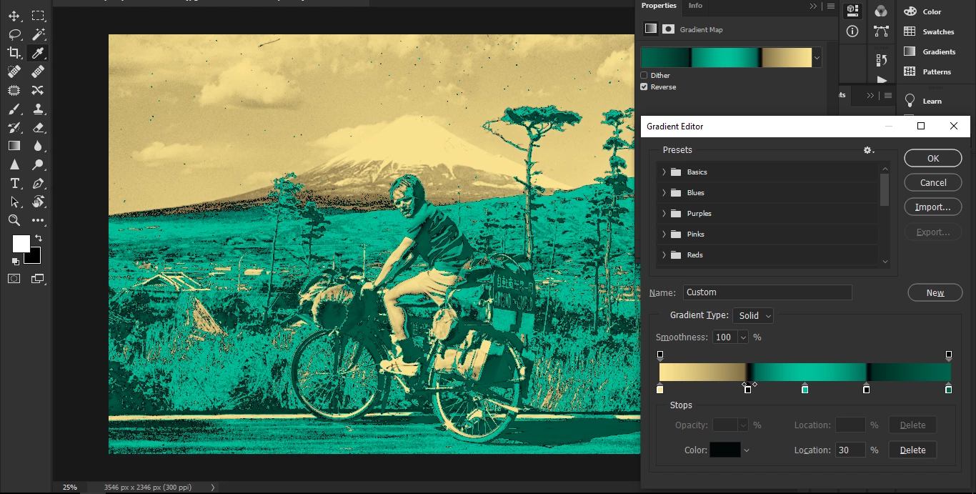

Hi there,
I am trying to create a posetrized / illustration effect based on the illustration that you see on the book cover screenshot below, with the use of gradient maps.
This is how my current gradient looks.
I am not sure that I need the black color stop twice to achieve the look as on the book illustration.
I know that that is an illustration, not a photo, and it's not based on levels unlike gradients.
But hand painting each of my image would take too much time for my workflow, so I am trying to automate it with gradients to achieve something similar as the illustration.
The 3 colors (yellowish, blueish, greenish) naturally distribute on the desaturated high contrast image, so that's fine, it's really similar to the illustration, but there are two caveats:
- how to achieve the black contour lines with the gradient? (I tried to add the black stop twice, still no black contours 😞 )
- how to isolate the blueish and greenish areas on the photo, just like on the illustration are?
(I don't want to really dedicate areas to these colors because the levels do that job, I just want that the black contours define these areas just like on the illustration)
Something I am doing wrong in my gradient map settings because the results are not similar to the illustration, I don't know what exactly, can someone help?

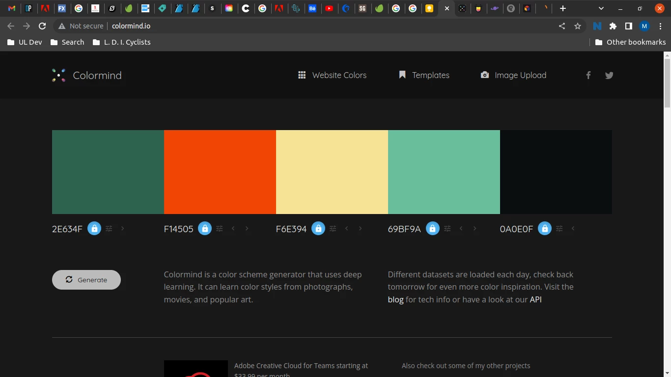

I attached the sample image, the colors screenshot with the HEX codes, and my gradient settings screenshot from PhotoShop.
Can anyone advise some good tricks with the use of the gradient to achieve the look seen on the illustration (almost) perfectly?
Thank you in advance.
Eventually what other tools should I use to achieve the illustration effect seen on the book cover sample?

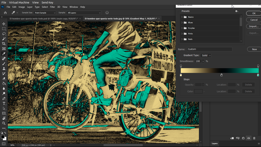

Just wanted to post this to show why I thought that what I want could be achieved with pure gradient map.
Just a three color gradient mapping, by putting the black in the middle, it creates black lines and isolated colored parts, just like the illustration:
But, once I bring in the dark green in the gradient, it's not this nice anymore.
So I am still busy with the tracing method you recommended.
Chris  P.  Bacon
August 16, 2022
I still don't understand how does this effect work in such a selective coloring way, cause why the blue doesn;t appear in the other multi tone black-ish areas? But I am sure that because the black is placed in the middle, that is what makes the black contour lines, and coloring by curved plus contour lines should yield a nice illustration effect. if this effect is on a portrait, there are very nice black contour lines created. if the black would be the last, then this would be a spotify style multitone image. bu putting the black in the middle i contour lines. by the way i still didnt manage to create the illustration effect with tracing. anyone want to try, wwelcome 🙂 but I am sure it works, as you recommended, just need to try more.
