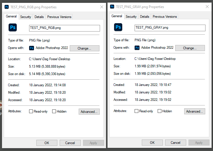

Jan 18, 2022 Jan 18, 2022
I'm still not seeing what you're apparently seeing.
Here's two compressed PNGs; an RGB at 5.14 MB, and a grayscale at 1.99 MB. I used Save A Copy here.
(Indexed color is sort of moot here. It will still cover all 256 values of a single gray channel, so no saving there. The saving in going to Indexed will only apply to RGB.)
