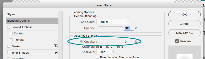

Hi!
Here is another option:
You can use a Gradient overlay on your shape with teh following settings:
1. Double click on your layer to bring up the Layer Styles Dialog box.
2. Click on Gradient Overlay.
3. In the Gradient Overlay dialog box, Click on the Radial Option from the Style drop down menu.
4. Then just above that, click on the Gradient Box to bring up the Gradient Editor.
5. Set the Gradient to be White on both sides (the stops on the bottom) and then click on the stop at Top Left and set the Opacity to be 0.
6. Click on the stop at the top right and change the opacity to be100
Then the last step, still in the Layer Style Dialog box, click on Blending Options in the left side of the panel and change the Fill Opacity to 0. This will set the original fill of the shape to 0% Opacity and you will only see the Gradient Overlay you just applied.
Let us know if you have any questions,
Michelle
