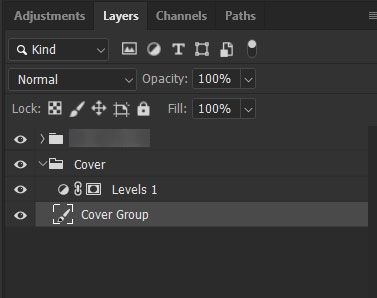

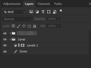

I have quite a bit projects which contain a layer group by the name "Cover" and I want to rename it to "Cover Group" using this action.
But into "Cover" layer group there is a layer with the same name. So when my action starts, instead of find and rename the layer group "Cover", renames the layer "Cover"!!!
Any idea how can I define my action so to rename the layer group and not the layer?
